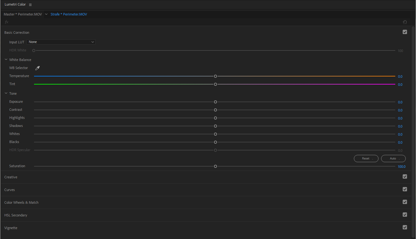

You seem to have a penchant for sliders. Welcome to Adobe Premiere Pro - Lumetri Color - Basic Correction:

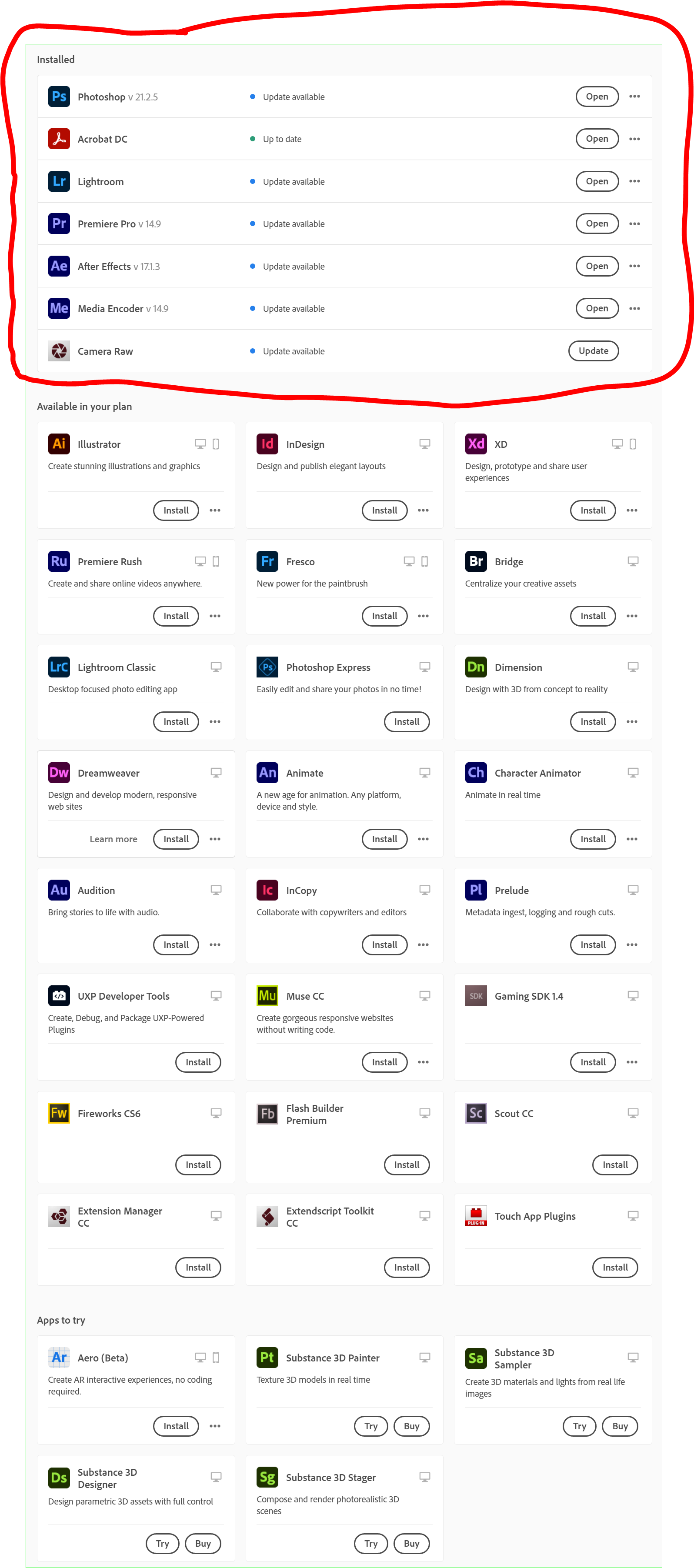

Though I'm personally paying for the full suite, I only really use Photoshop, Premier Pro, Media Encoder, Acrobat (for .pdf editing), Camera Raw (occasionally), Lightroom (rarely) and After Effects (still learning).
My GF is a web developer, so she uses Dreamweaver, Illustrator, Acrobat and InDesign. Because we both use different software, we split the cost of the entire suite. Because I shoot and edit drone video several times/month, I can justify the cost of my half of the Adobe suite.
