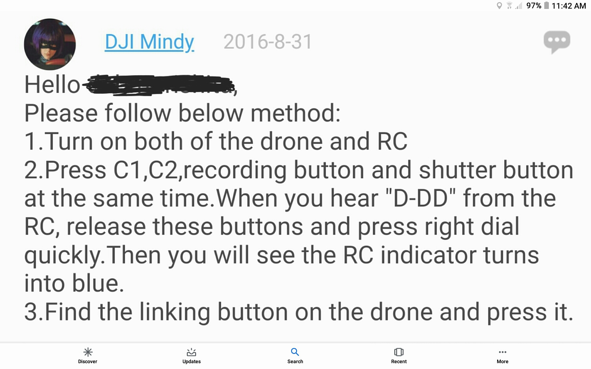

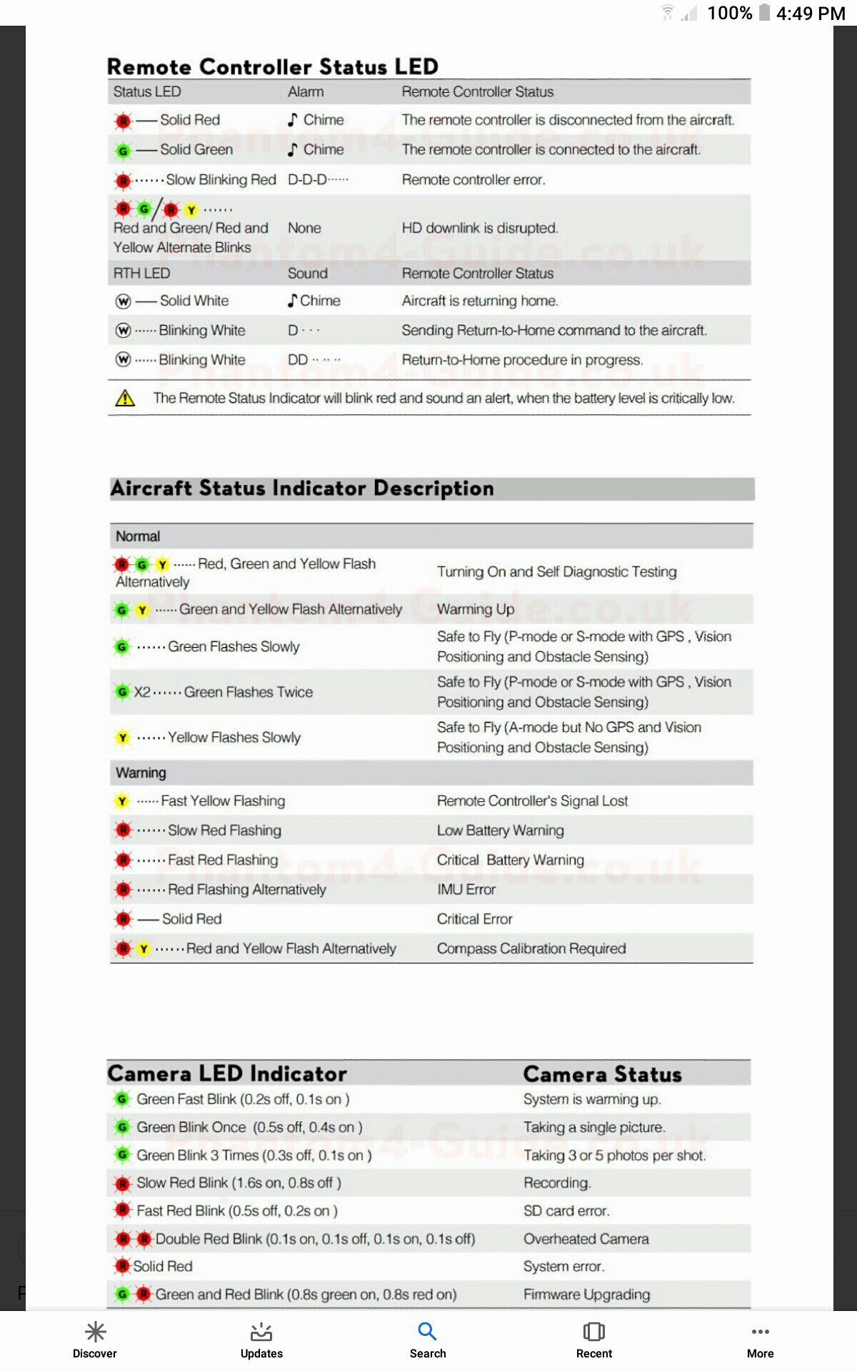

Wow where to start,? Here a light chart,front just for show always red unless turn off,,does the app still open ok ? Is that how you try linking,,,try a manual link without app ,,
I'm sure your lights ok sounds like right sequence,,just work on the linking,ps you might need to press link button twice with this side facing remote,seems to work better I find (I change rc offten),

, though I have only tried pressing once the button on the side of the aircraft (as you see in video) but it doesnt go in bind mode. Weird thing also is that I cant connect by usb to the pc anymore (although I was able to up to the point it started flashing red-green-yellow), it seems like the p4 is in some sort of safe-mode. I will try with the manual way you show from the rc button press combination and report back, thank you.
OK just to check when you try linking with app are you in rc linking in settings,once here and you press rc linking it should get onscreen prompt saying confirm frequency and press ok,,it then should start beeping till link button is pressed,,is this what you did,also try turning rc on first
