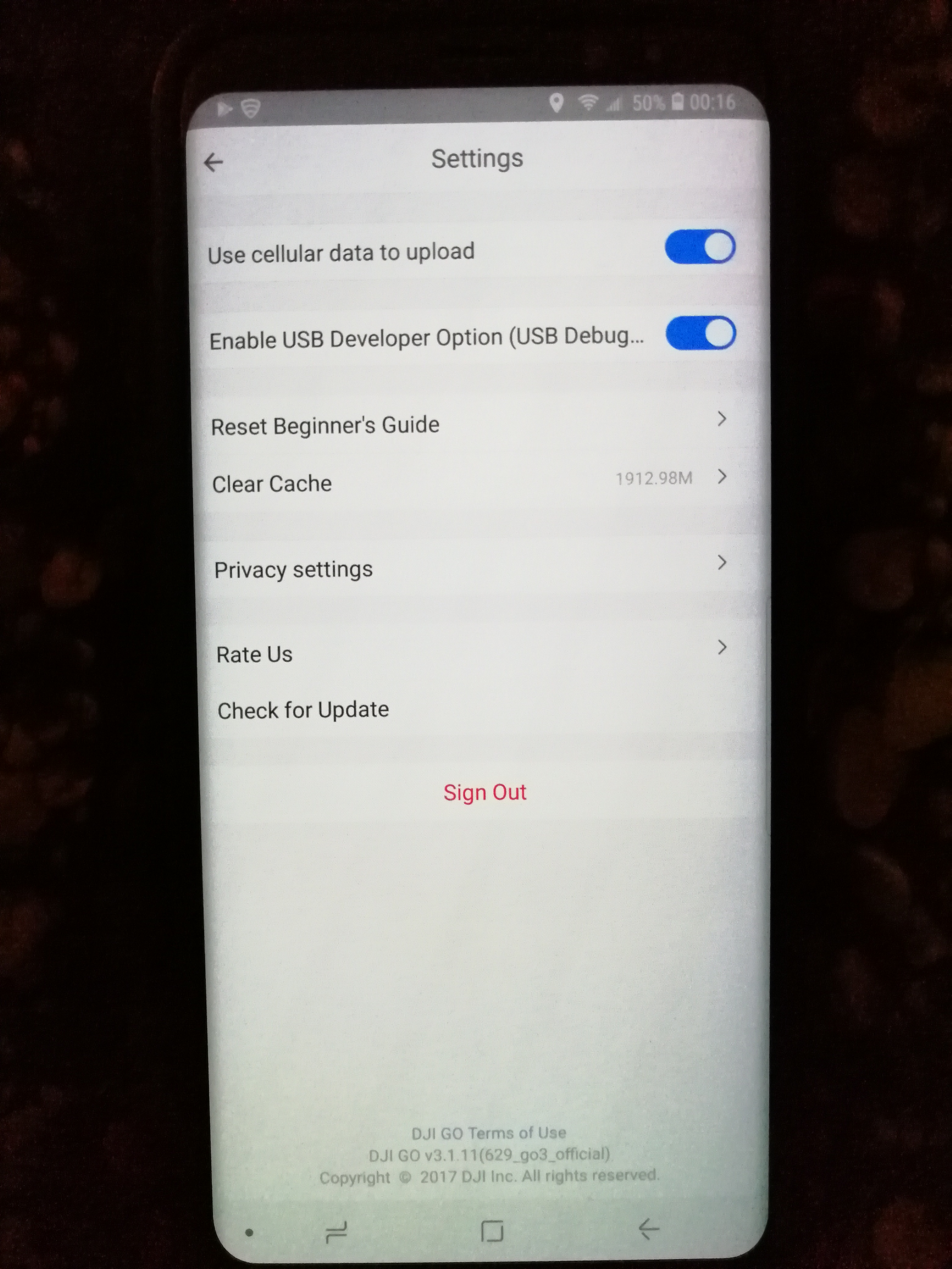

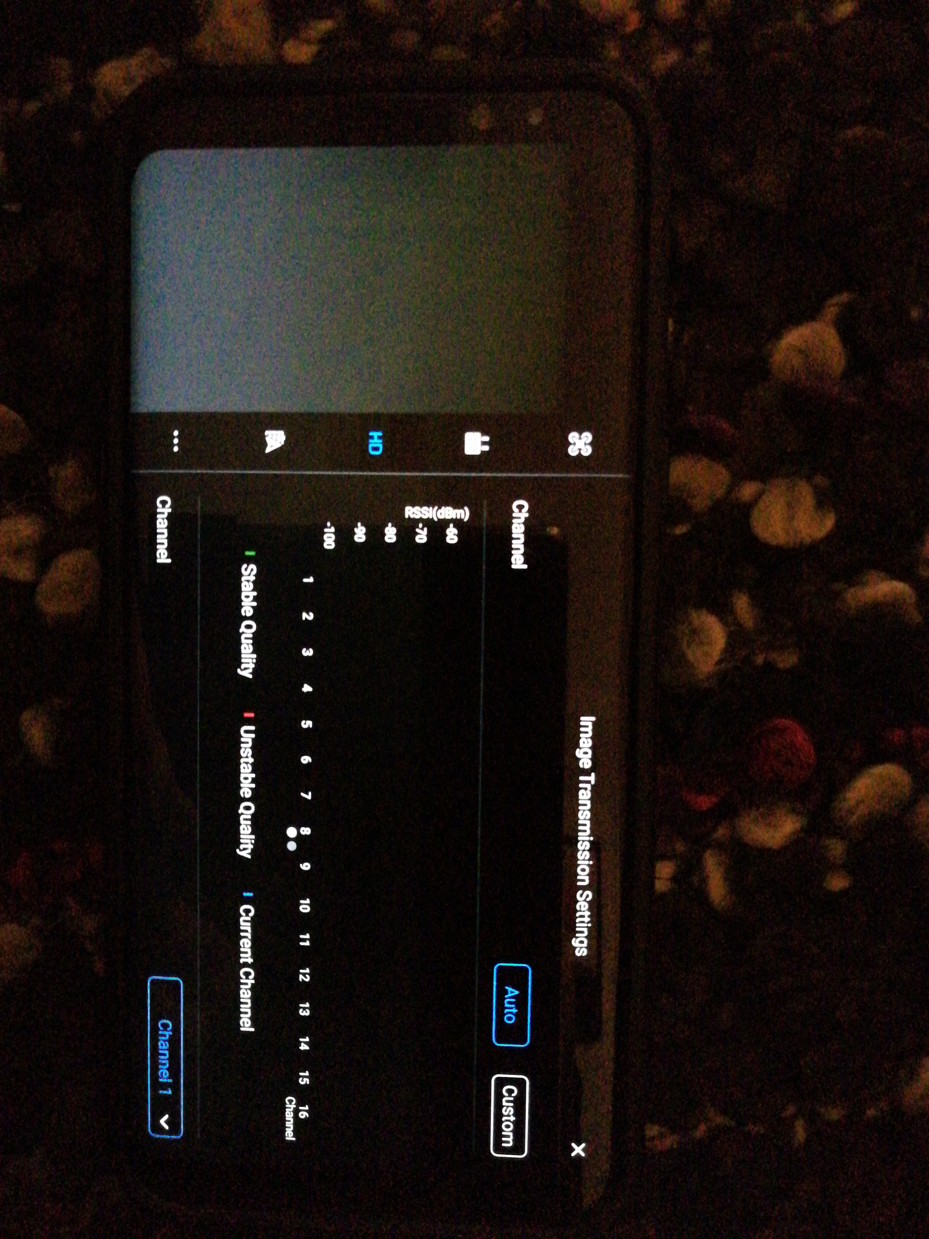

I can confirm that it works with the DJI GO version v3.1.11 (629_go3_official). I have used it on a Samsung Note 3 and a Samsung S8 plus successfully.
