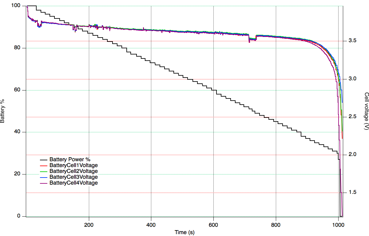

I'm not convinced that any of the battery cells are bad - it looks more as if the software was mis-reporting. If you look at the voltage progression on all the cells it appears fine, even though they seem to start a bit low, until it falls of a cliff at around 900 seconds. That's short in terms of flight time, consistent with not having a full charge. The abrupt end is consistent with the software starting the flight at 100% when it should probably, based on voltage, have been around 70%.
Where did that chart come from? "50% battery" is not 2.5V, 2.5V for a battery cell is dead battery territory. GO App / the aircraft itself is grossly misreporting or completely ignoring cell voltage for some reason.
That cliff you see after 3.5 is exactly what LiPos do, the app should be reporting 0% here, and the bird should've landed well before that point. This should be a relatively straight forward warranty case with DJI, although they seem to prefer refurbs over brand new replacements.
The chart data are directly from the log file for the flight in question. I agree completely about 50% not being 2.5 V - that was exactly the point I was making about the software mis-reporting.
