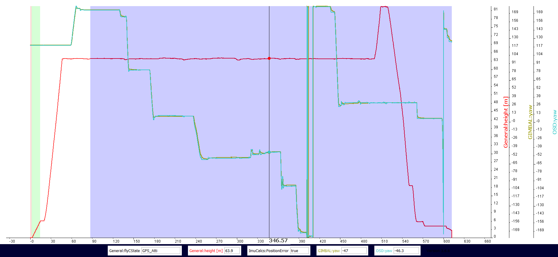

It could be, but I am going to say that this is not a gimbal issue. The IMU Positioning error is in this data as well. Its co-incidental possibly, but in all 3 data sets, excluding only one that did not have the error, all of these showed up in the first 80 seconds or so of each one. Below shows the error and the gimbal yaw angles which are within 1-2 degrees of the aircraft center.
Ok I think we're narrowing it down. Do you think the IMU Positioning error is something to be worried about. Also would this error affect the drones flight path?

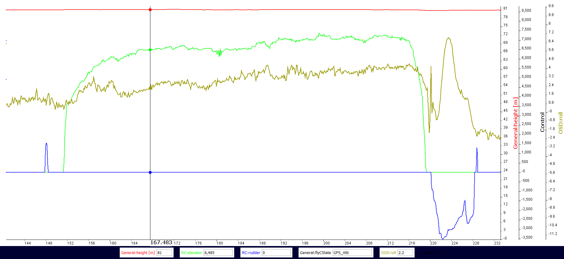

That rudder command was intentional I suspect and is not part of the area I was looking at. I am looking between 167-219 seconds for a straight flight with no inputs. You can see the +2 to 3 degree roll with only the elevator applied.
I've watched that segment a few times now and just not seeing what you see after the last commanded turn at 147.913 and then the turn at 219.852. Raining today so can't stream in HD, may or may not be a factor, probably not but .
There is a twitch at 228.921 following his rotating around to the left followed by slight and slow correction the the right (4m 10sec mark). The camera twitches slightly "left" just as or maybe just a hair before he lets completely off right rudder.
As to recenter itself But nothing logged I see to account for it in the player and by no means rotating fast enough at that point for synchronized gimbal pan to act?

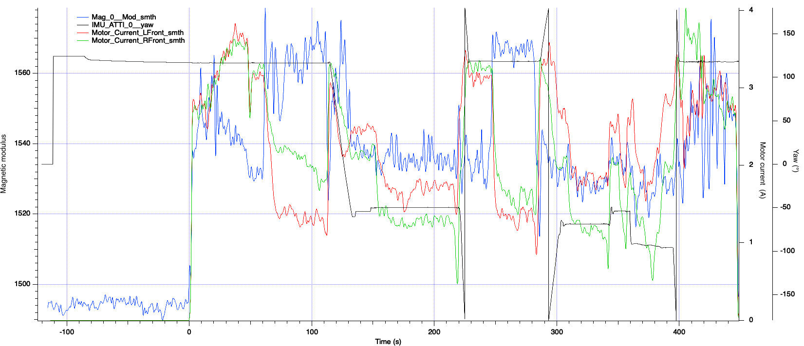

Thank you so much for looking into this. What does this mean in layman's term. Is one of the motors failing or going bad?
No - the motors are fine, but compass 0 appears to be being affected by the adjacent motor power cable. Here is a better view of those data:
It's more common to see the compass data affected by tilt and yaw, which implies an uncalibrated magnetic characteristic on the aircraft, but that doesn't appear to be the case here - it really looks correlated with motor current. That has been seen before, if I remember correctly, due to poorly routed or untwisted motor power cables.
To summarize, since there is so much speculation in this thread, the problem seems to be that the IMU is getting systematically bad heading data from the Mag0. That means that it is not facing the direction that it thinks it is, by up to 10° in some cases. When you apply elevator to move forwards, that results in the actual track not matching the (incorrect) heading, and so it crabs to correct. The FC thinks that the aircraft (and camera) are facing the direction of travel.
The offset is variable in magnitude and direction since it depends on the interaction of the spurious magnetic field (that appears to be motor current induced) with the earth's magnetic field.

One question if I may, where did you get the source of the "Mag_0_Mod_smth" plot from in the signals list? I looked under Mag(0) but can't seem to match it.
Mag_0_Mod_smth is processed - it doesn't exist in the DAT file or the DatCon conversion. It's Mag_0_Mod with a rolling 50 point binomial smoothing function applied to make the data more easily visualizable.
