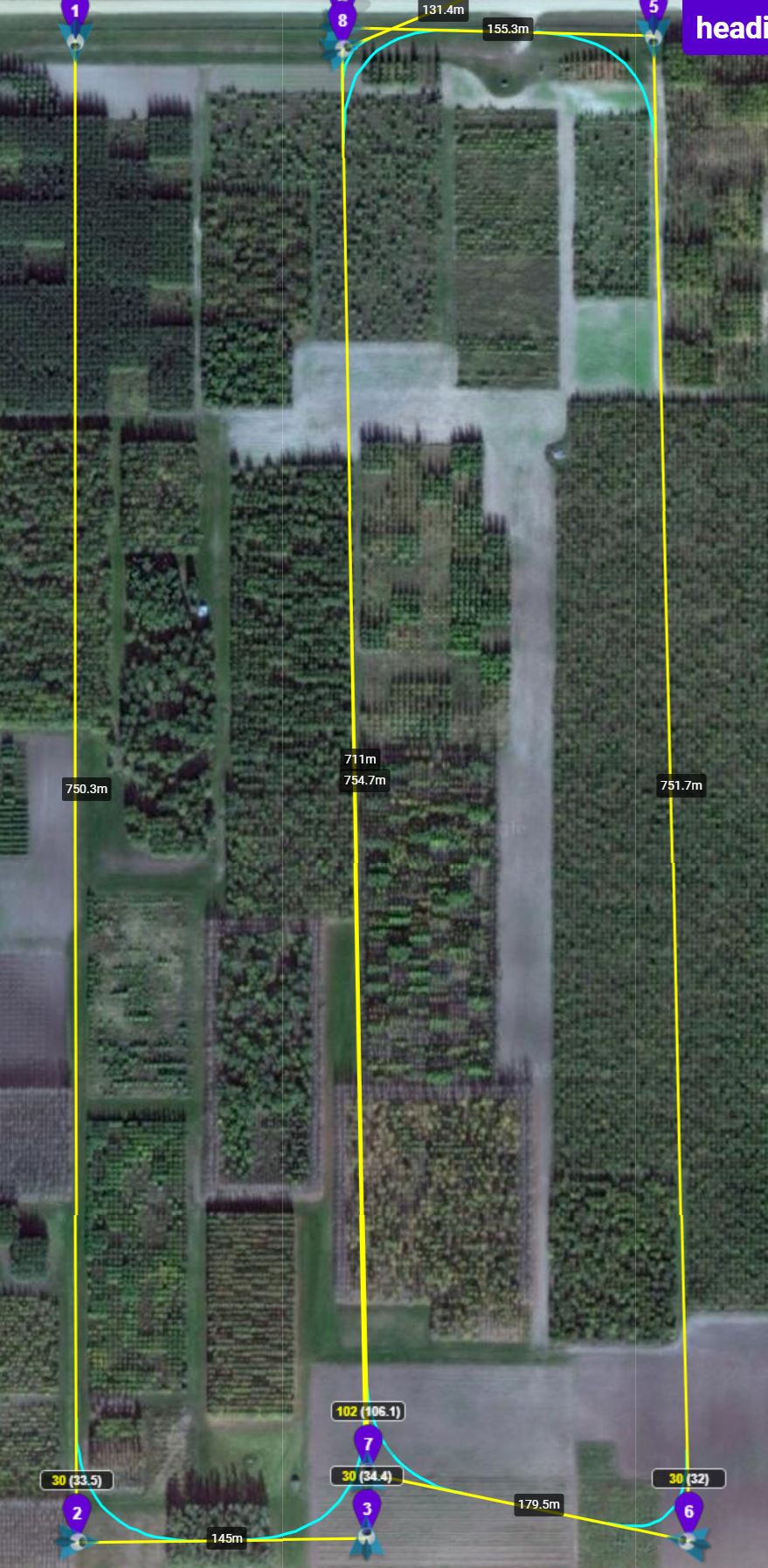

Here is a screen cap of the mission, you will notice waypoint 2 is right in that gap, however I realize that may not translate to exact coordinates when it's flown. In any case you can see the drift in the video,
