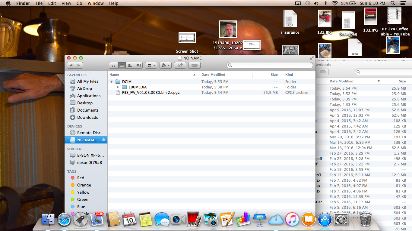

.bin2 is the problem. It should be .bin for it to run. (Just delete the 2 & copy it to your root directory). Nothing else on the sd card. \

I have a Mac also. To unzip a file, simply click on the one that ends in "cpgz".
This will open up a file ending in "bin". You have "unzipped" the file!
Attach the usb cable from computer to bird, and turn on the battery.
Copy and paste or drag and drop the file ending in "bin" to the sd card
Listen for the bird to begin updating.
