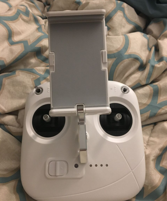

Just wanted to post my "hybrid" setup - aftermarket mount with Phantom holder. I bought the holder from a fellow member (Thanks Jeff), and another member here recommended this mount: AF Phantom 3 standard Mobile Device Holder (support DJI-PH3-P38)
So far, so good. The mount is very sturdy. There is a slight a gap between the bottom of the mount and the controller. It didn't seem to affect the sturdiness, but I cut a piece of a business card and stuck it in there because I didn't like the gap.
The only 2 negatives is that the new mount's lanyard hole is wider, so I need to get a larger clip. Also, my phone with its case is a little thick for the stock phantom holder. It works, but the phone can slip out if turned upside down for example. My tablet was very tight in the holder.
This setup cost me around $35 total, which is the same as the Inspire kit. I just wanted this so I didn't have to drill.

Thanks for the info, I purchased the standard mount you showed and an inspire 1 device holder, should make it pretty much just like the advance and pro device holders..
Helidirect is where i ordered mine, ordered it yesterday morning and they shipped it yesterday afternoon.. ordered both pieces from them. guess i got the last one lol.

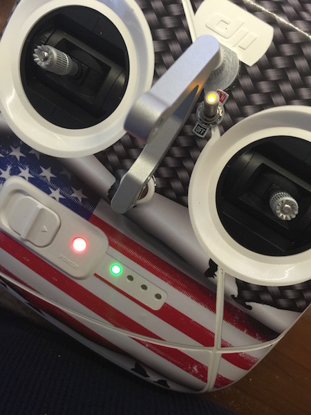

I went the no drill CNC & Jellyfish route. Works great. Got the Jellyfiish bracket for a full tablet, and it fits my iPhone 6 Plus lengthwise and the iPad Air2 width wise.
However, after assembly of the CNC to the controller (took a couple of tries, no directions[emoji34]), I have a piece left over. Did I miss something?

I went with the cnc arm and Square Jellyfish mini tablet holder also.I think that piece goes in the hole before the CNC arm goes on . Smaller hole for screw to keep the arm from wiggling.
