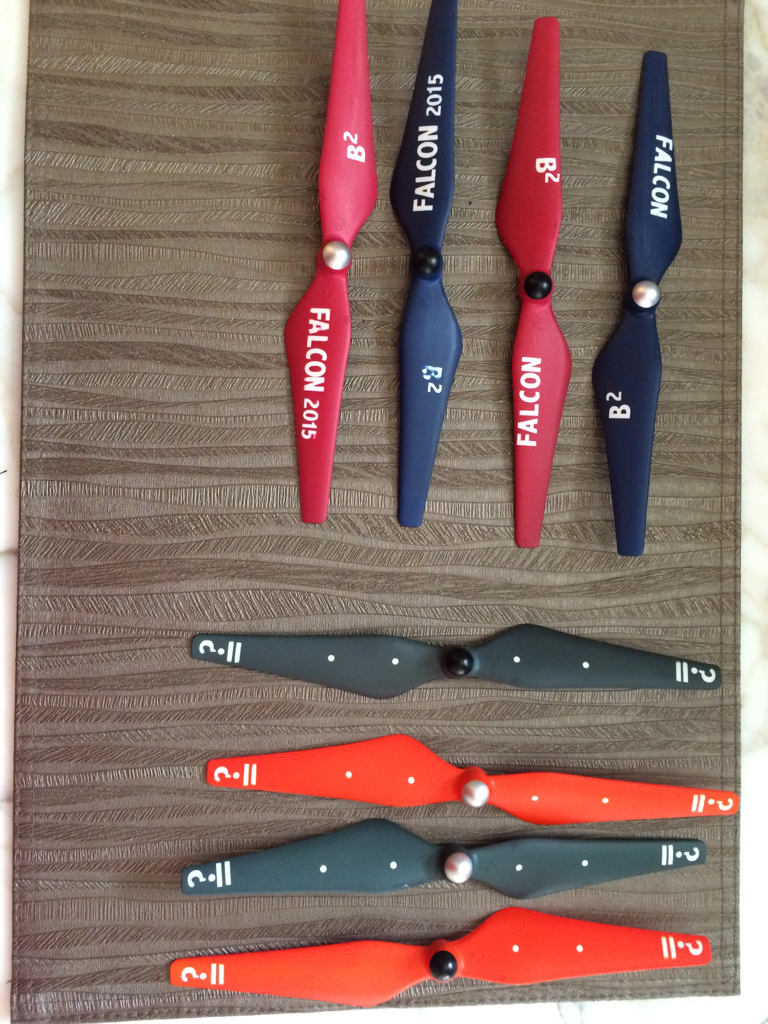

Here's a combo that I did. I used cherry red and pearl grey. The grey, if you use too much dye, end up super dark. Almost navy blue. Then I redid the grey lighter and lighter. I was going for Buckeye colors. OH!
How'd you get the white logos on the props? Did you tape them when you dyed them?Trust Dirk. He wouldn't steer you wrong. Good luck. I live my dyed props. View attachment 30460
Just so happens this is exactly what I bought to try. Does the water have to be that hot 194F? Almost seems that temp could cause warping on the props. Thought I read that 140F was the temp to go with.Here's my attempt at dying my props. I wish they came out a little darker. But they match the color I picked out. I used the liquid Rit and only used about 4 table spoons and 4 cups of water. Heated the water to 90 Celsius and put the props in for about 25 minutes.
