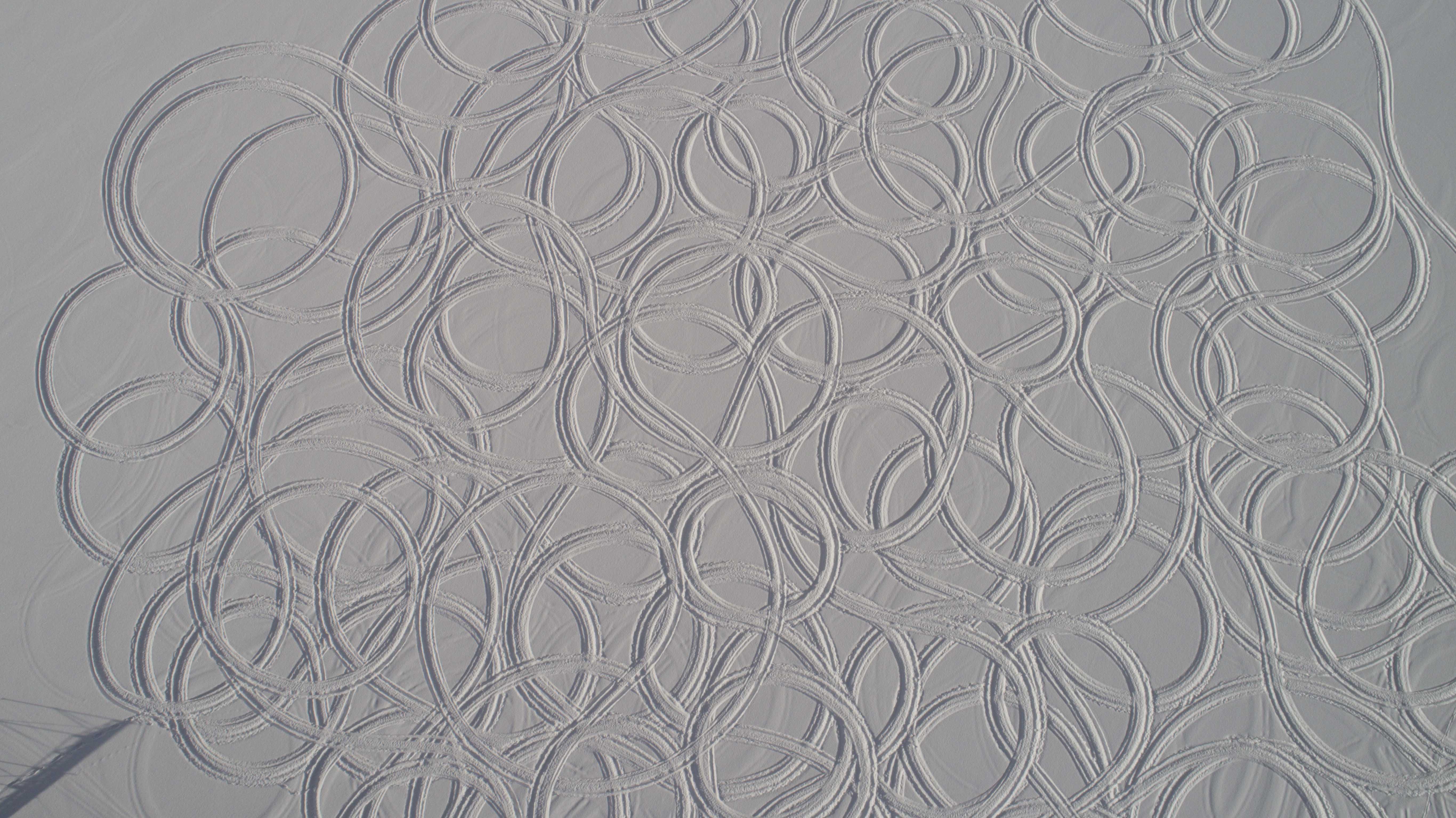

I just got my 4Pro and my raw files all have a red glow or cast in the centre of each image. Any thoughts on how to remove / prevent this?

This sounds like a defect.
The color-cast is definitely there, almost like extreme vignette. I have seen one other example here with a similar monochrome snow-theme.This weird image is go snowmobile tracks (drawing). The edges are quite green and center red-ish. Not sure why. My 3Pro doesn't do this.
I think I would send a sample to dji for their comment and potential replacement.

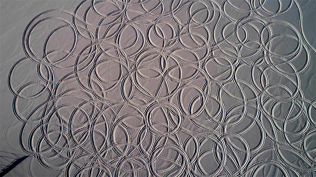

(the region with the red color-cast easier to see in the version below)
Well if you have a defective camera...Thanks Tomas. I will send to DJI. Disappointed with the raw files and what I thought would be the image quality of the 4pro
Actually the leds coloring the haze is a good explanation. It should then only appear in some images and not all, however.Try turning off the front LEDs, my P4 will do that in hazy and overcast days or at dusk.

Yes the sun was above the drone but not behind. When I shoot the same thing, same time with the 3Pro it doesn't halo like this. Must be defective camera. Have sent info to DJIHmmmm seems like you have a "Halo" effect actually.. What was the sun's position when you took the picture? Was it behind and above your drone?
Its a good thought, but the drone is very high and I can't imagine the LEDS would cast to this degree from such a heightActually the leds coloring the haze is a good explanation. It should then only appear in some images and not all, however.

Thanks. I'll look into that. First I'll see if I can get a replacement as my Pro3+ doesn't have any of these issues shooting same subject same time of day. I could take the CA out in post but the overall quality is just not even as good as the 3Pro+ I already have...There is alot of CA in the image too. Maybe this could be contributing to the color cast. Have you tried shooting with an ND filter or even a UV filter? I shoot with Lee Filters on my DSLR. Insanely expensive but they give off a purplish cast that I have to fix in post. Just a thought.
