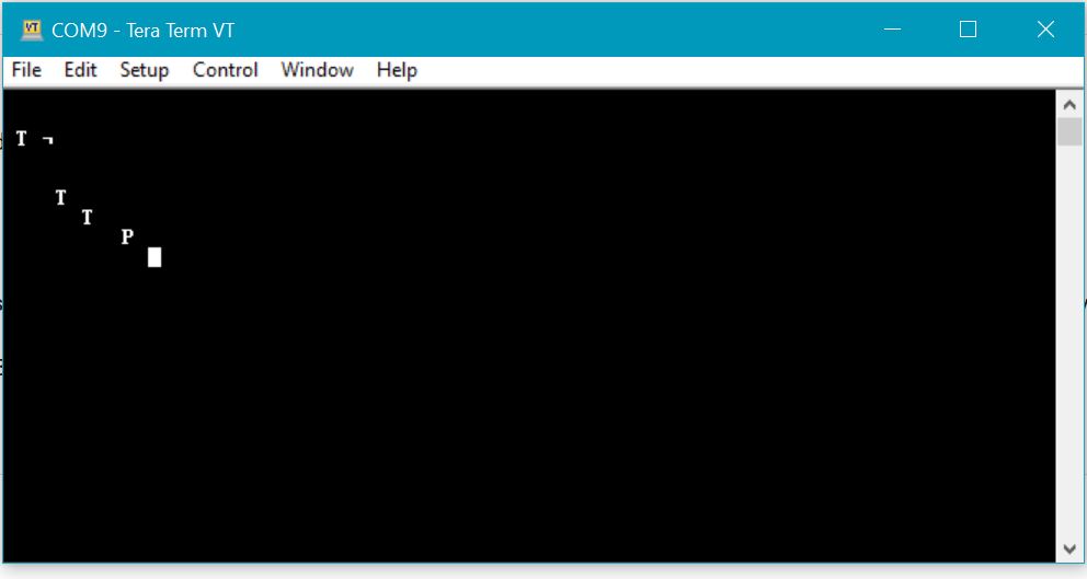

I am not able to go further after connecting to Tera term, not getting the BOOTME message, only getting weird characters along the screen, Anyone can help here
You should really read the guide I linked you.
You apparently did not read "Booting the board with debug interface connected".
