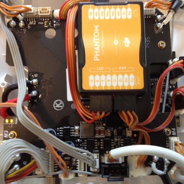

Well, the only way to find out is to open it back up. Once open and take a full horizontal photo of the main board. Save the photo in a file on your computer's hard drive and use the Upload a File button to load it like this photo so it can be enlarged. You'll see an enlargement button at the top of this photo.

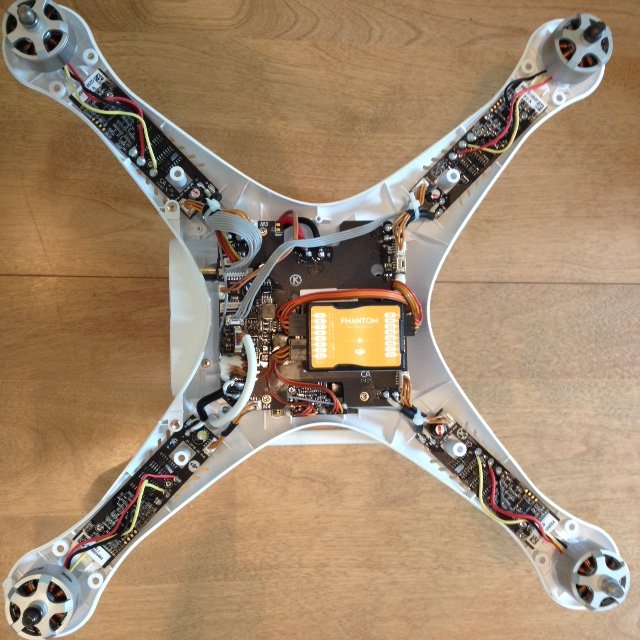

If you decide to replace the board be sure to take detailed photos before replacing it. The Naza-M module is held on with double back tape make sure you also take photos of all the wire connections to that module. Many haven't and could not figure why it wouldn't work.
Once the board has been replaced you will need to do an advanced IMU calibration. You may have to pair RC controller with the P2s receiver.
