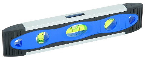

Yes, you should actually check the surface with a level. I use one like this:
