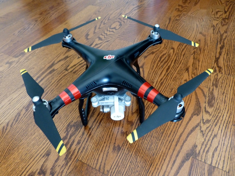

I painted my P3, including the compass with Krylon made for plastic almost a year ago. Works fine and doesn't come off. I had the shell apart for other reasons. I would probably apply a skin if there was no other reason to take it apart, unless you are really good at taping off little things.

Those are Dji CF props in the picture. I have recently gone back to my painted OE props. You can put stripes on the OE props with masking tape before painting. Either way works fine. For me, both props perform the same.

It's not too hard, but time consuming. Then it's nice to "make it your own". And it's a bit easier to see in the sky (if you paint the underside, of course.) White props in this pic.

I removed the upper shell (pretty easy - I had to straighten it after a crash anyway.) So it required no masking.
I masked and bagged the VPS, gimbal, motors and LED lights on the lower housing.
Painted with Krylon safe for plastic spray paint. I used satin, but gloss might be even better.
If there are any little spots not to your liking, you can touch them up with a q-tip after.
I painted the props also and it did not change their balance.
To date there has been no chipping or wear.
The paint did not adversely affect the antennas or the compass in the landing gear so paint away :)
