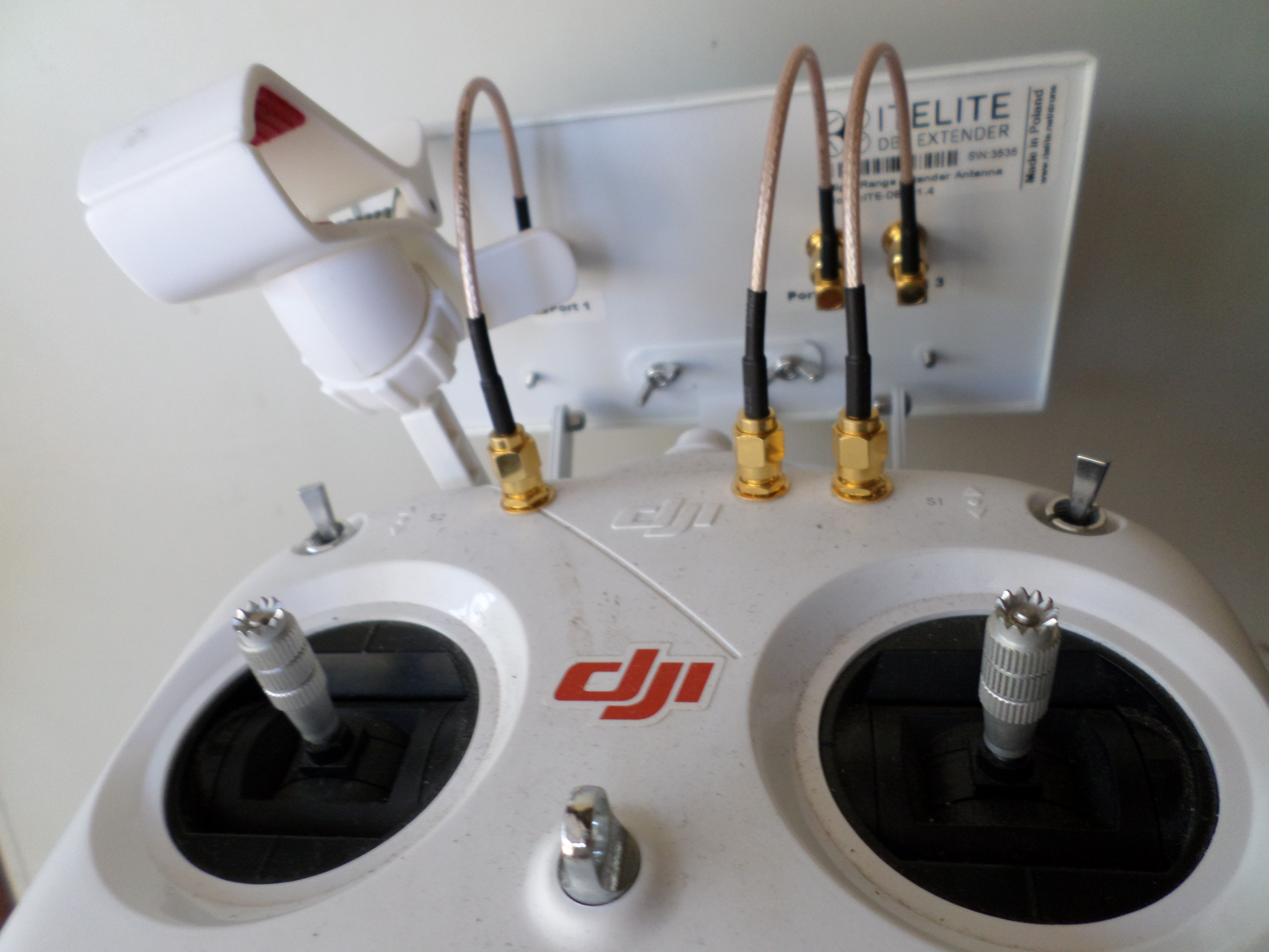

I've got the DBS setup on my Standard, as well. More than doubled my range, plus it's a lot neater than 3 separate sticks, to me, anyway.

I fitted Argtec ... slapped Icarus software on and upped to 27dbm ..... in semi urban wifi area ... hit 2063m when control signal dropped but video was still strong. Very happy with it.

i'm also in ce zone, italy, but to reach 200m i mount DBS and two cloverleaf on bird.
now i'm waiting for a two way 5.8 amplifier with a dc dc step up converter from m3.7 to 9. to power amplifier from rc.
with stock configuration and 1.5.7. maximum fly distance was 70m.
now with dbs yesterday in rural area i reach 300m altitude and 300m distance but it depend from bird rotation.
to reach max ditance the drone must be at 90 degree from rc axis.
