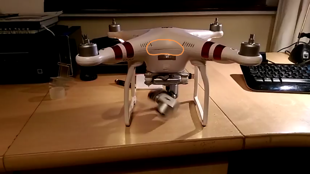

Hi All.
As per usual around this time of year there will be lots of questions being asked and as a newbie I'm going to add to that.
I bought a second hand Phantom 3 Std and was assured that it had never been crashed or dropped and by the condition of it I would believe that. The seller did say that after installing the latest firmware the camera started to flip back up when it reached 90 degrees but thought it was a software problem.
I have carried out the firmware upgrade again but the gimbal goes crazy on power up. Video attached.
Couldn't get it to up load here.....wrong file extension?
I have done the following:
1: Replaced the ribbon as there was a very slight kink in it.
2: Carried out IMU cal
3: Carried out Gimbal Cal
4: Carried out Compass cal
5: Removed rear plate and checked D Shaft alignment
The gimbal does settle down after 30 seconds or so but the camera wants to drop very slowly, by adjusting the gimbal control upwards it does finally settle but if I go too far on any axis the camera flips back to centre most times.
I have watched sooo many videos on youtube that I've gone past the understanding bit.
If any of you kind people have any further suggestions please help me out
