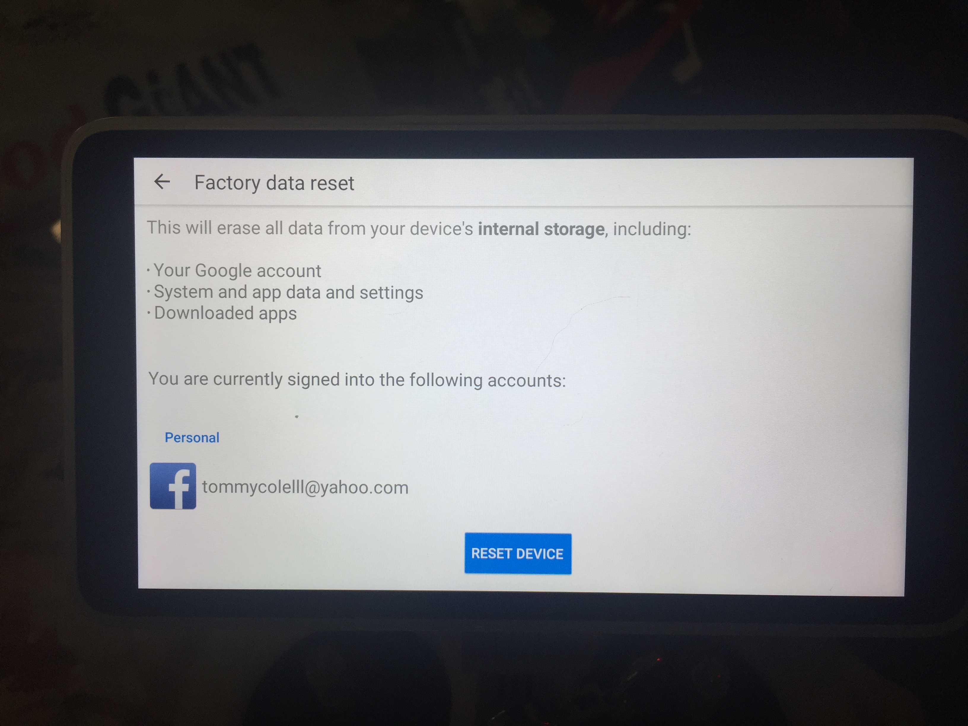

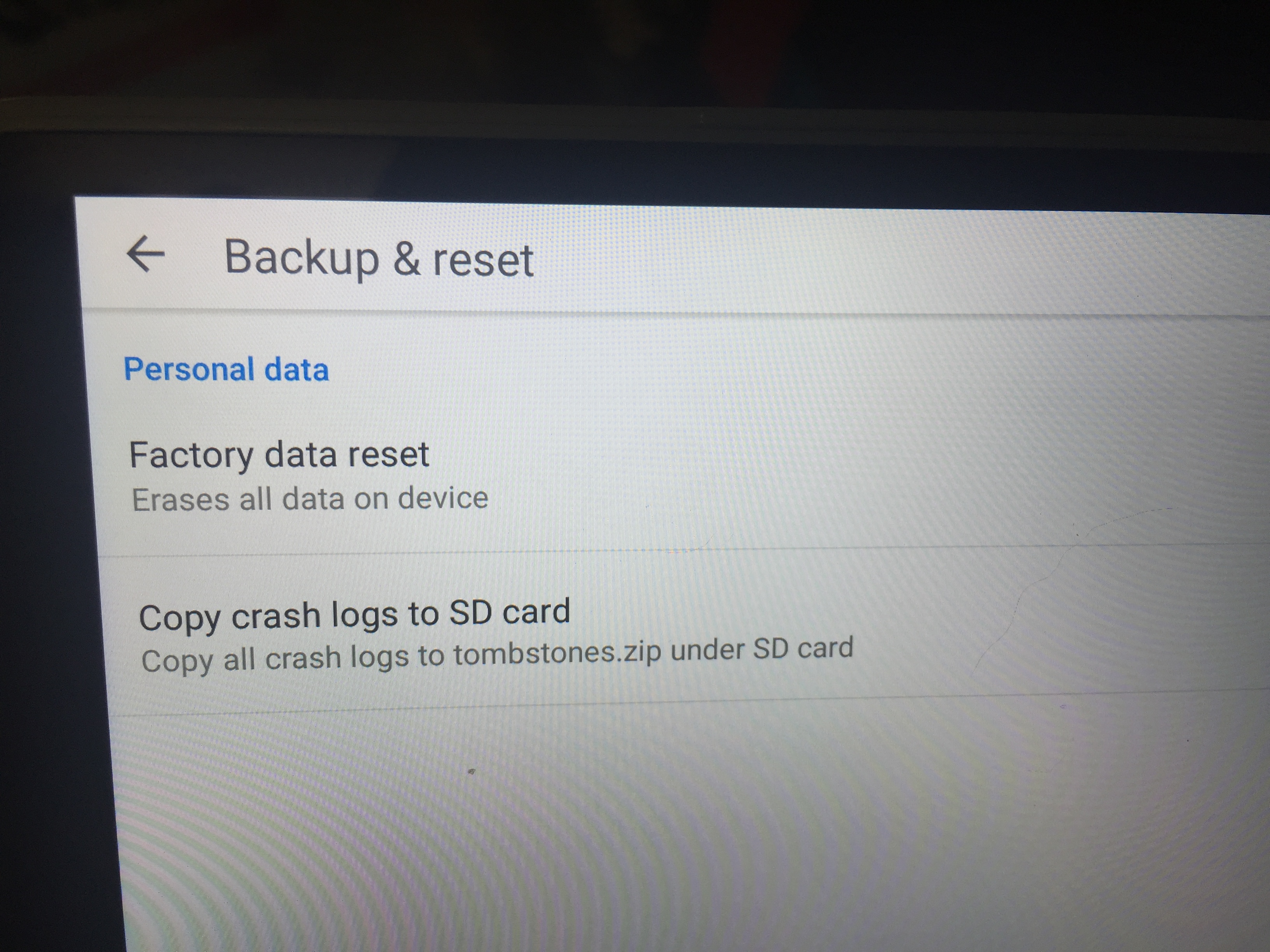

View attachment 84799 View attachment 84799 View attachment 84800 im having same problem with p4p+. i think that i should not have turnrd off the mainland china green button?
will i really loose this stuff, am i at the rite place?
ThanksI have p4p+. You should turn off mainland china if turned on. Factory reset needed to fix your issue. I went through the same after upgrading, downgrading then updating again in order to get a solid working update for AC and RC.
