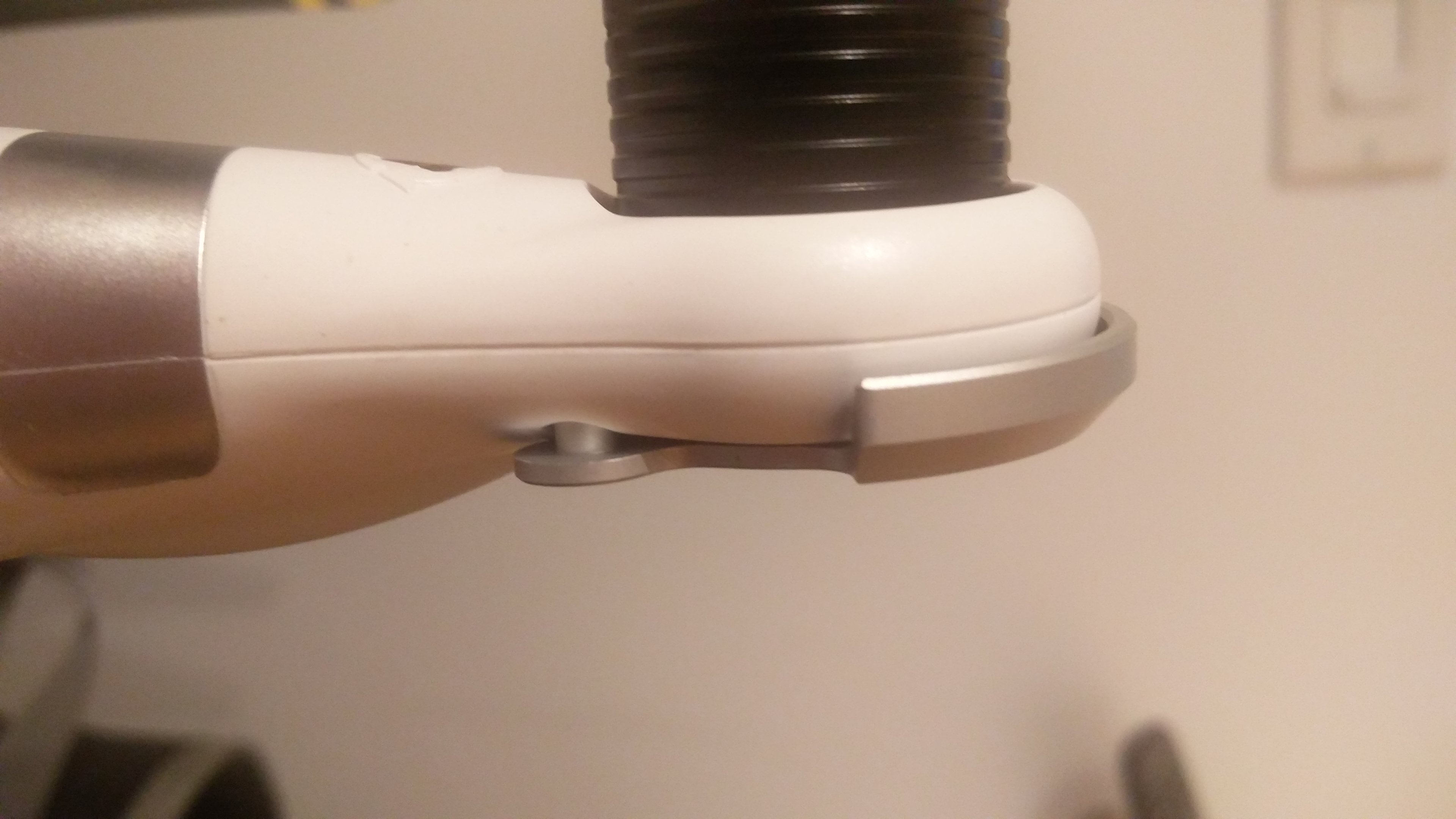

Where did you get the reinforcements? Thanks.
They look like (or are very similar to) these: Infinity Hobby
I have these from Infinity Hobby, and I like them. Hard to tell if they prevent cracks--I have not had any cracks since using them, but I also filled the inside of arms with Plast-aid. What I like about them is they don't protrude out much from the arm profile (barely 3mm), so my P3 still fits into the cases I have. Some of the arm reinforcement plates (like the UAV Bits ones) stick out further and they would require enlarging the arm openings in the foam case inserts. They also look pretty nice with the brushed aluminum look.
I also like Infinity Hobby's motor covers: Infinity Hobby
I have no affiliation with Infinity, just a happy customer of these items.

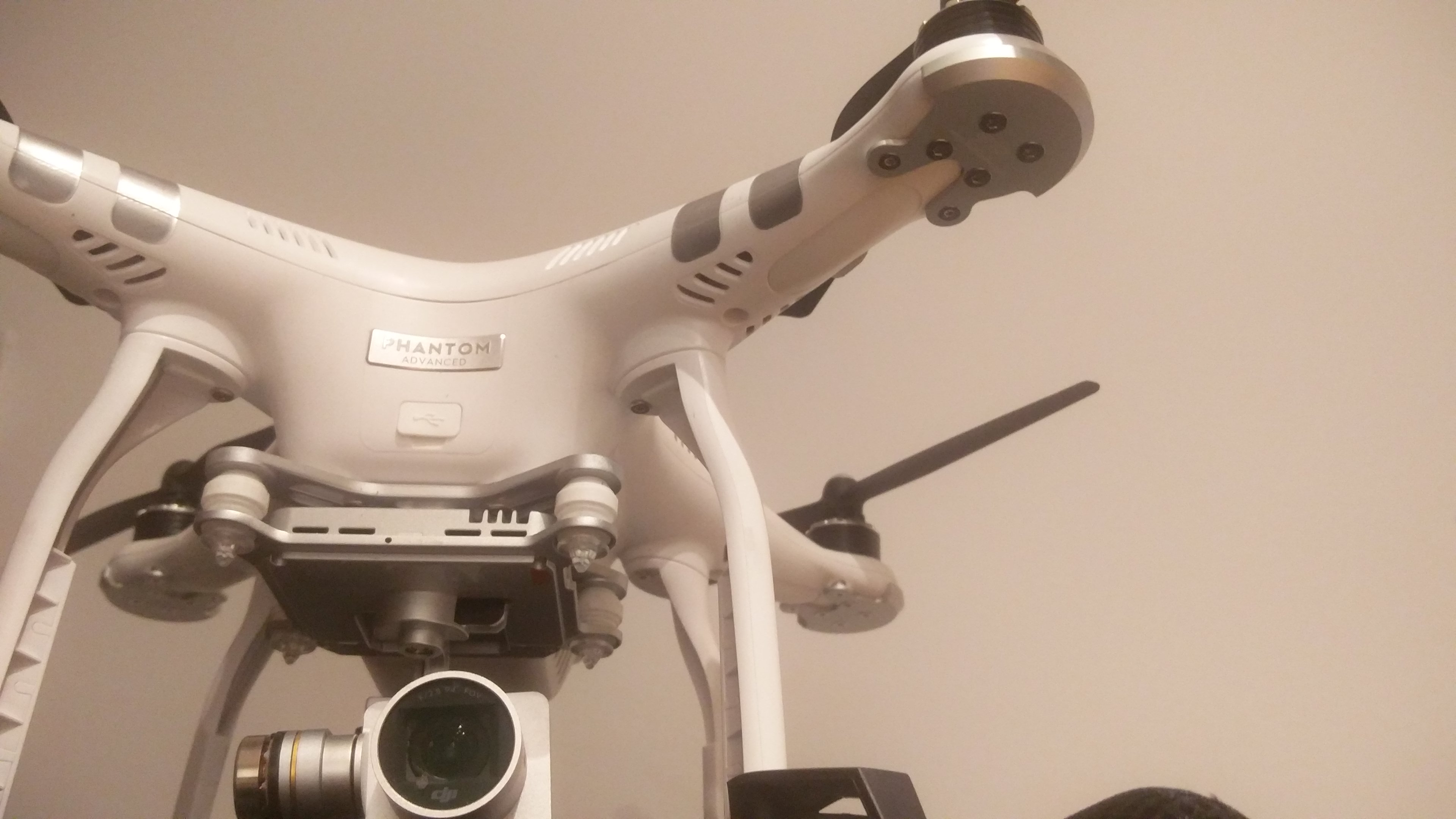

You could've googled me.
With reinforcements,
View attachment 61579 View attachment 61580
I noticed you have retaining pins on all four gimbal cushions. DJI recommends you put them diagonally in only 2 positions allowing the cushions to work more effectively. Thought you'd like to hear since you are obviously going for the best possible experience.
@Dounin Front yeah I was just testing to see if there's any noticeable difference, none that I could see, went back to 2

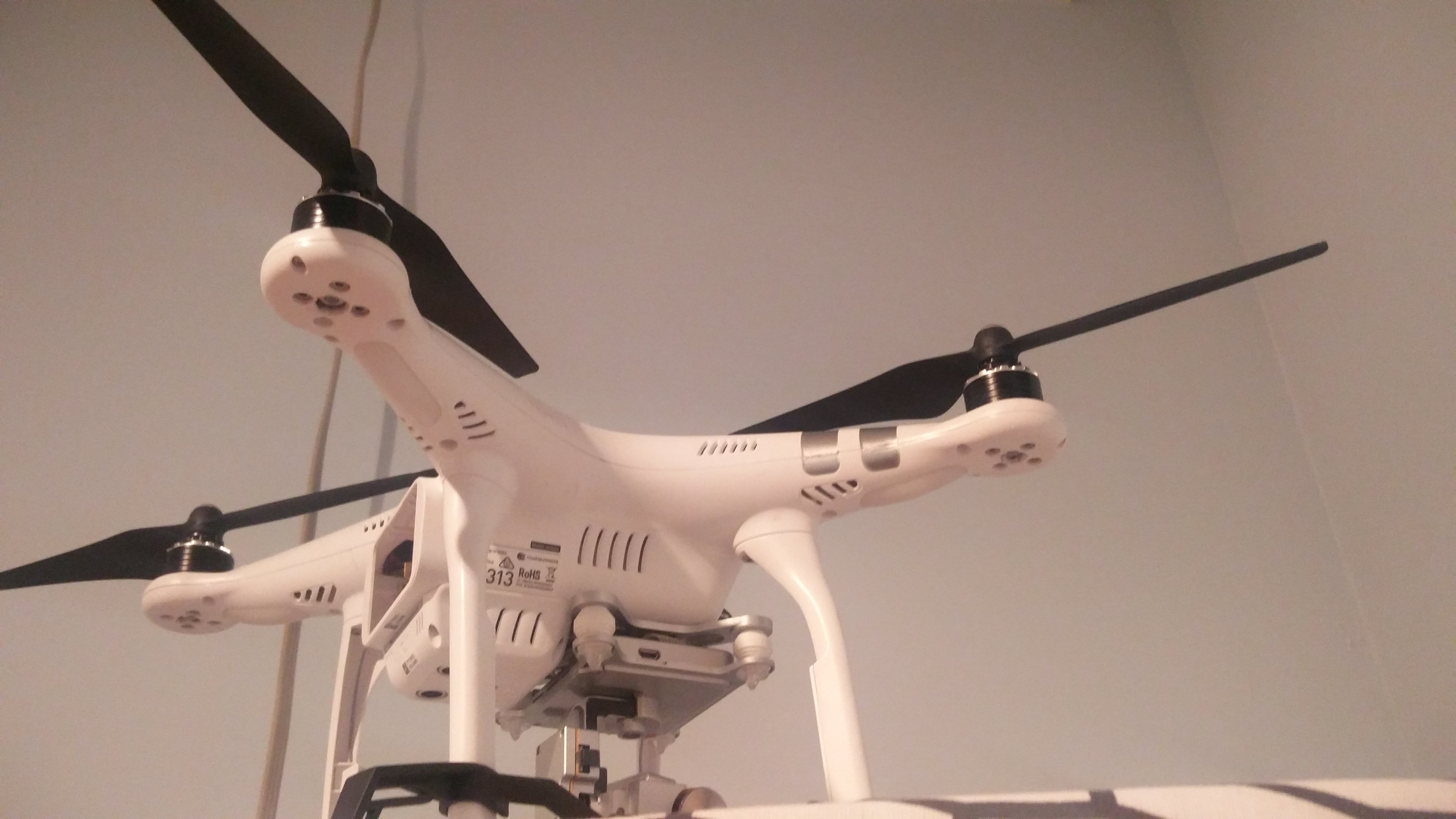

Hey guys got my p3a about a month ago, been loving it every day. I got the KDE motors about a week ago and so far very impressed. Definitely more agile, much quicker 0-35mph(is there a mod that unlocks top speed?).
View attachment 61574 View attachment 61575
Use ATTI mode, set the switch to F. Don't forget there is no GPS and you have to brake yourself.
