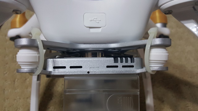

Why do you recommend using zip ties? What advantages do they have to using anti drop pins?
Anti drop pins are "weak" and breaks apart easily. It doesn't take much force.

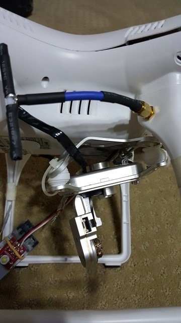

Zip ties are easier to remove then anti drop pins and provide more stability as you can use 4 zip ties instead of 2 anti drop pins
The anti drop pin actually don't provide "stability" and you don't want it to either. This is also why I said the zip tie should be on very losely. Enough for the white dampener to stretch out.

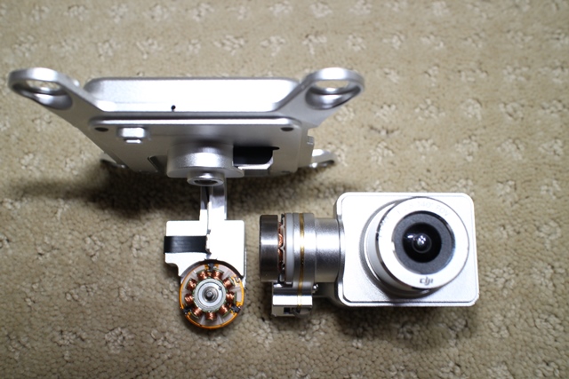

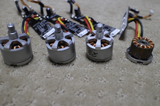

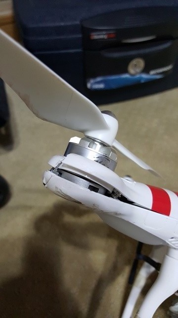

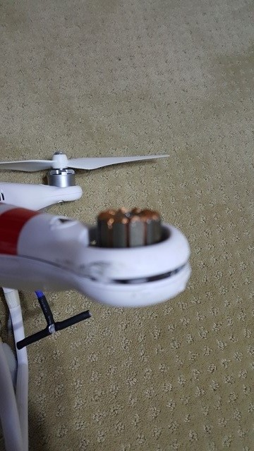

View attachment 39308 View attachment 39309 View attachment 39310 View attachment 39311 View attachment 39312
Yesterday in my crash I broke one anti drop pin
Sent from my iPod touch using PhantomPilots mobile app

In a real life 60MPH impact...here's what happened:
