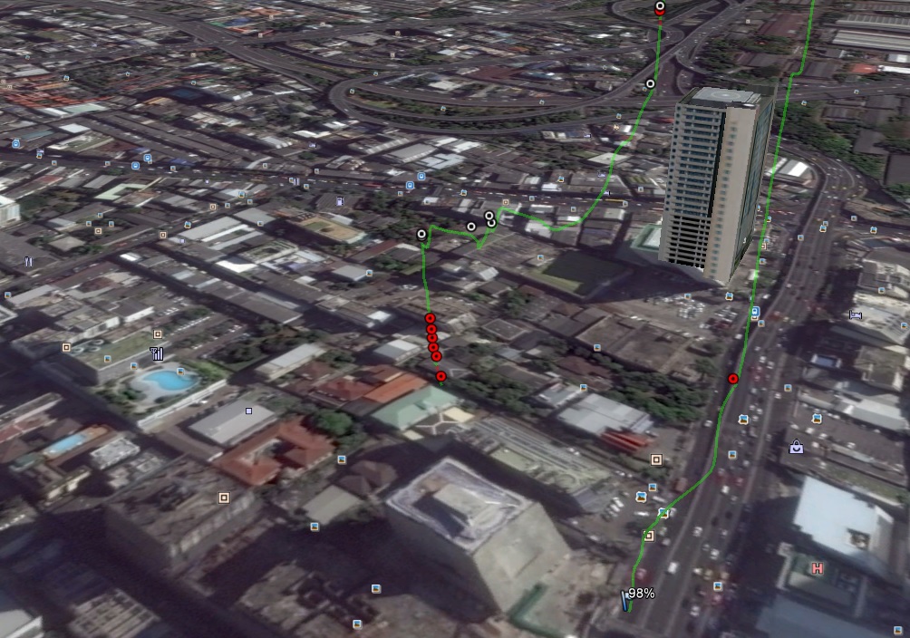

Here's where it landed:
Thanks for the assistance. The image you attached showing where it landed is a bit deceptive as the building to the left of the 98% is actually a 40+ story building. The red dots directly above the it in the image is likely the roof of the building. Would that be correct to assume? I'm heading there shortly to see. Any other thoughts you have are appreciated.
I'm guessing it either landing on the roof and is sitting there now, or hit the wall on the roof and is busted around somewhere up there.
I'm at the mercy of the accuracy of Google's satellite images. The important takeaway is that your Phantom most likely landed somewhere on that building.
