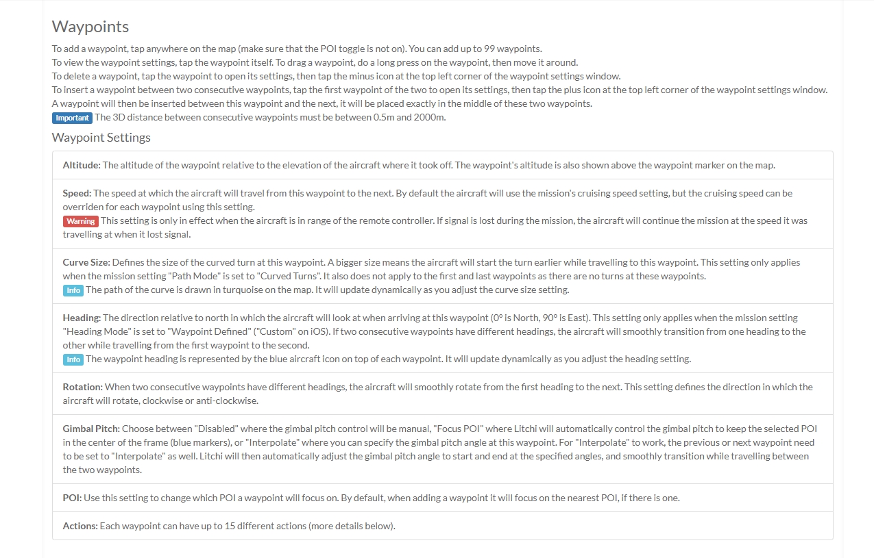

I've had issues with my Litchi Waypoint missions failing to load but I only get a written screen message and not the voice of the "nice lady".
The Litchi manual states the 3D distance between consecutive waypoints must be between .5 meters and 2000 meters. See attached.
Today, in flight preparation with my P3P, I loaded a simple 4 waypoint mission with about 45 feet between consecutive waypoints. "Mission failed to load". I repeated the load twice and each time it failed. I hit the start button anyway and after 10 seconds or so it seemed to fly the mission and stop which the "nice lady" announcing something like "mission has completed".
