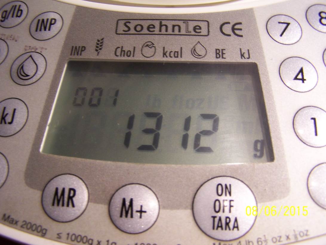

How Much Does You Phantom Weigh?
I don't blame you for not carving your P2 with the Zenmuse gimbal. From what I have seen, that gimbal is already pretty light and doesn't seem to have much to trim away.

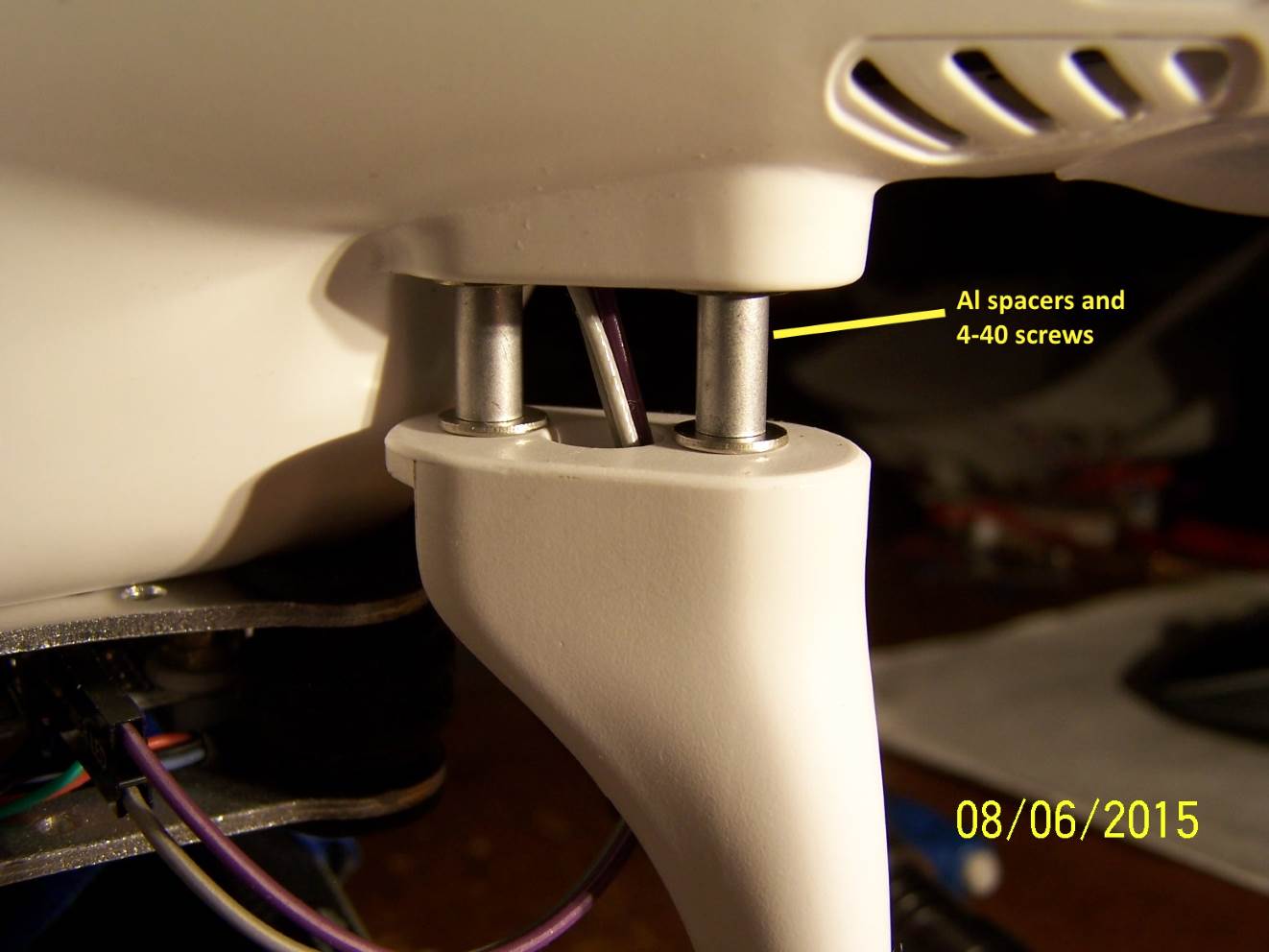

What do your landing gear clip extensions look like?
I used some 0.5" Al spacers, retapped the holes for 4-40 (real close to the metric screws they use), and am going to try making some spacers out of lexan rather than the spacers, for better support. Hopefully they won't weigh much.

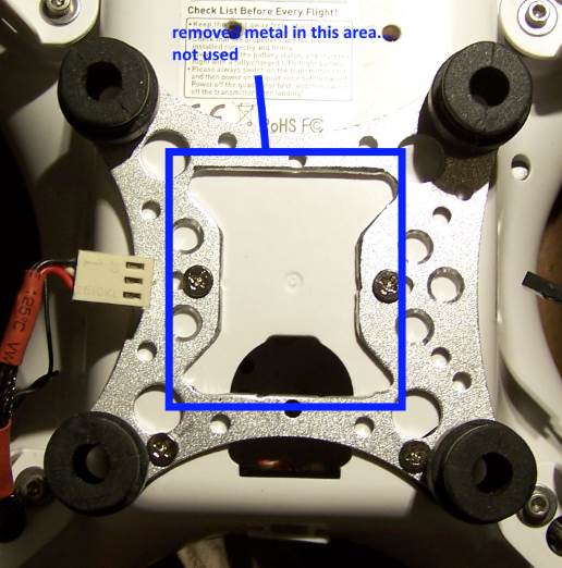

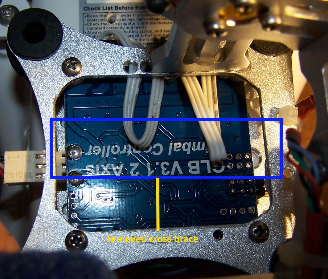

ANYTHING to get rid of weight and increase fly time without increasing the possibility of failure.

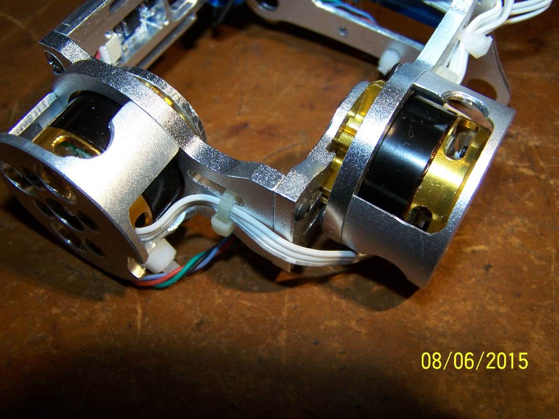

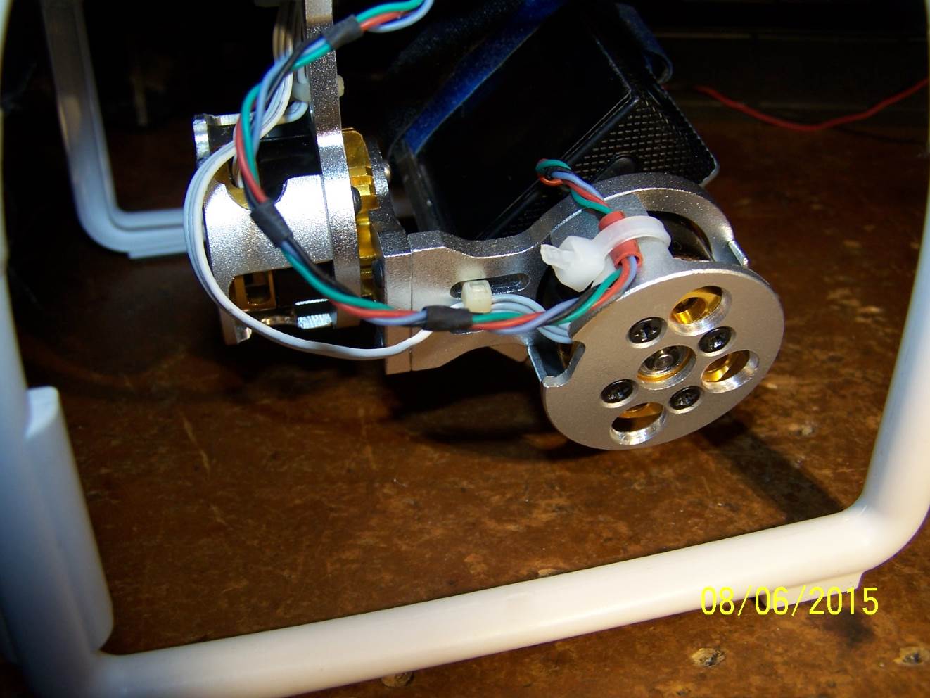

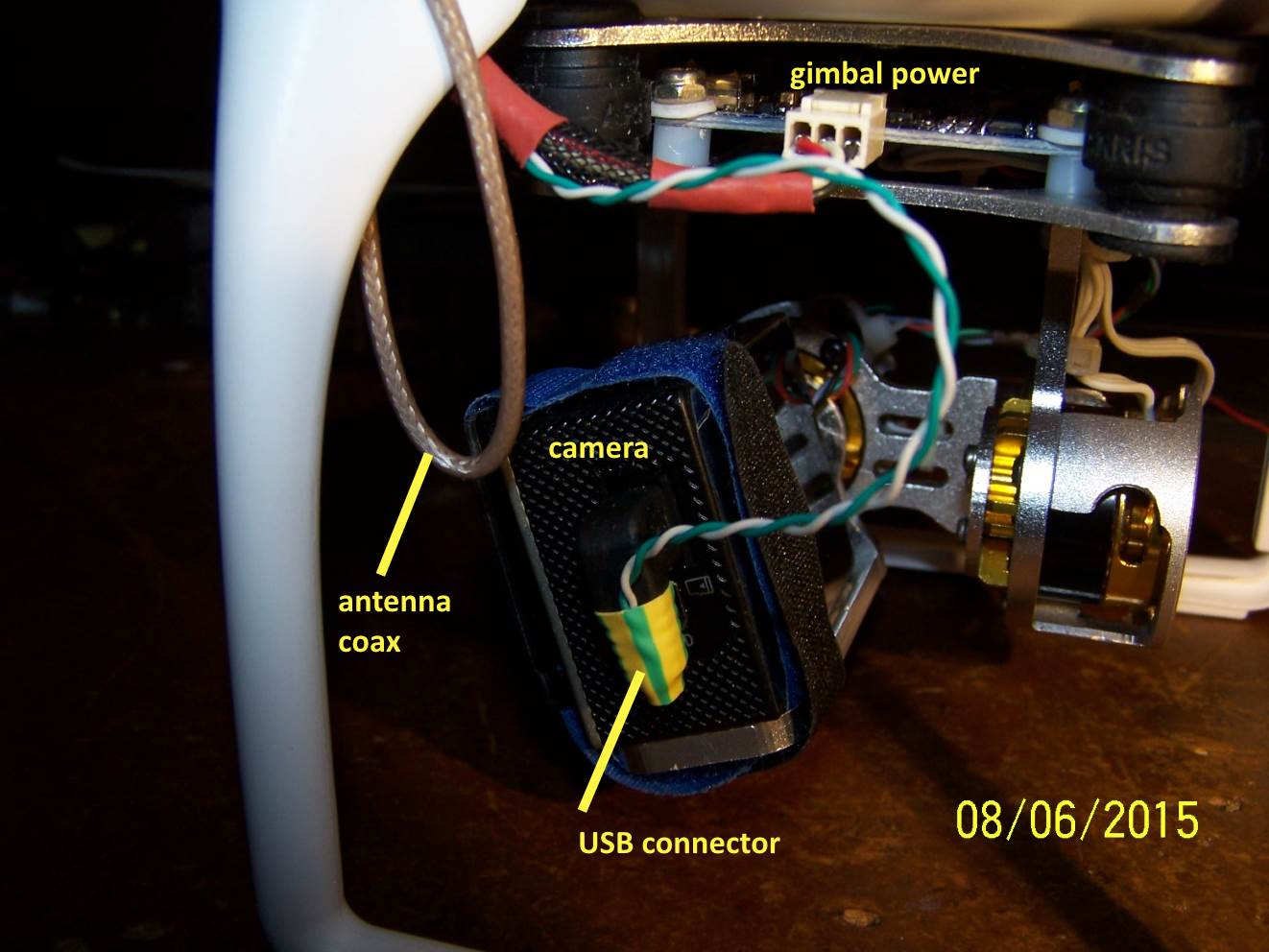

The gimbal had MORE than enough "beef" in the motor mounts, so I tried just drilling holes in the motor "cups", but the more I looked at it, the more I thought "I can get rid of more material" so I plunked it down into the mill and cut away.
Didn't cut any of the bosses for the screws though as they were small already.
Made a difference though, so it was worth it! Each motor "cup" was 13g, and after milling they are down to 6.9g each! Almost half :eek:.
I guess I will have to stop and fly the **** thing though! ENOUGH MODIFICATION!!!! :confused::rolleyes:

There isn't much to say, but IF you do decide to mill away any of the cups, I wouldn't cut too close to the screw holes and bosses in the cup.
Those are the where the tiny screws thread into, and you really don't want to get rid of any of the material around them.
Not to sure how it is going to fair IF I crash (and we all know I will NEVER crash....RRRIIIIGHT!):rolleyes:
Also, I don't know if it is clear enough, I drilled a few holes in the end of the cups around the motor mounting holes... just not TOO close.
The material doesn't really cut like Al, so it may be some alloy... kind of gummy, but it does file somewhat like Al. It is not ferrous, so it may be a cheap grade of Al... don't know for sure though. (or my cutter wasn't real sharp!)

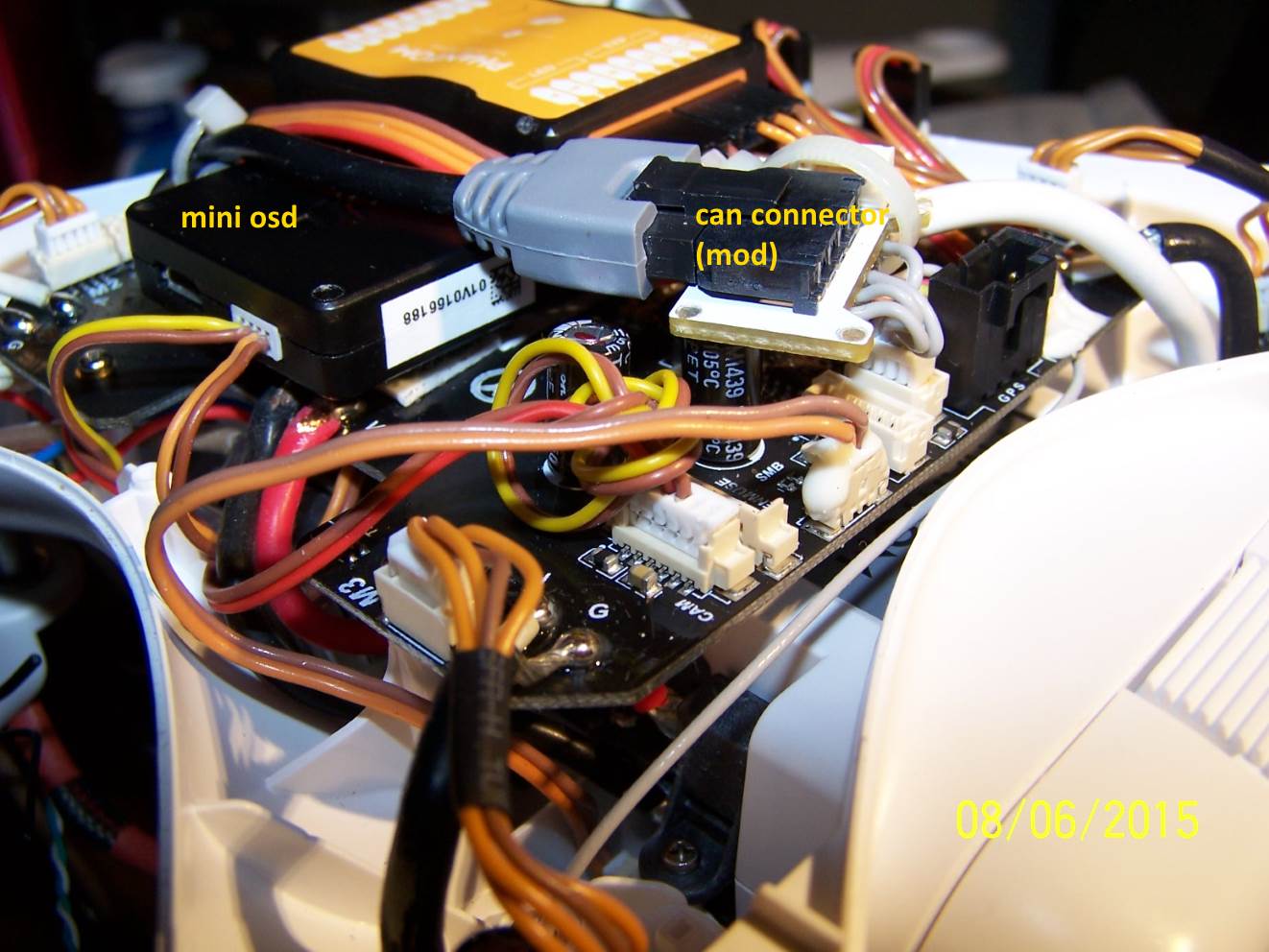

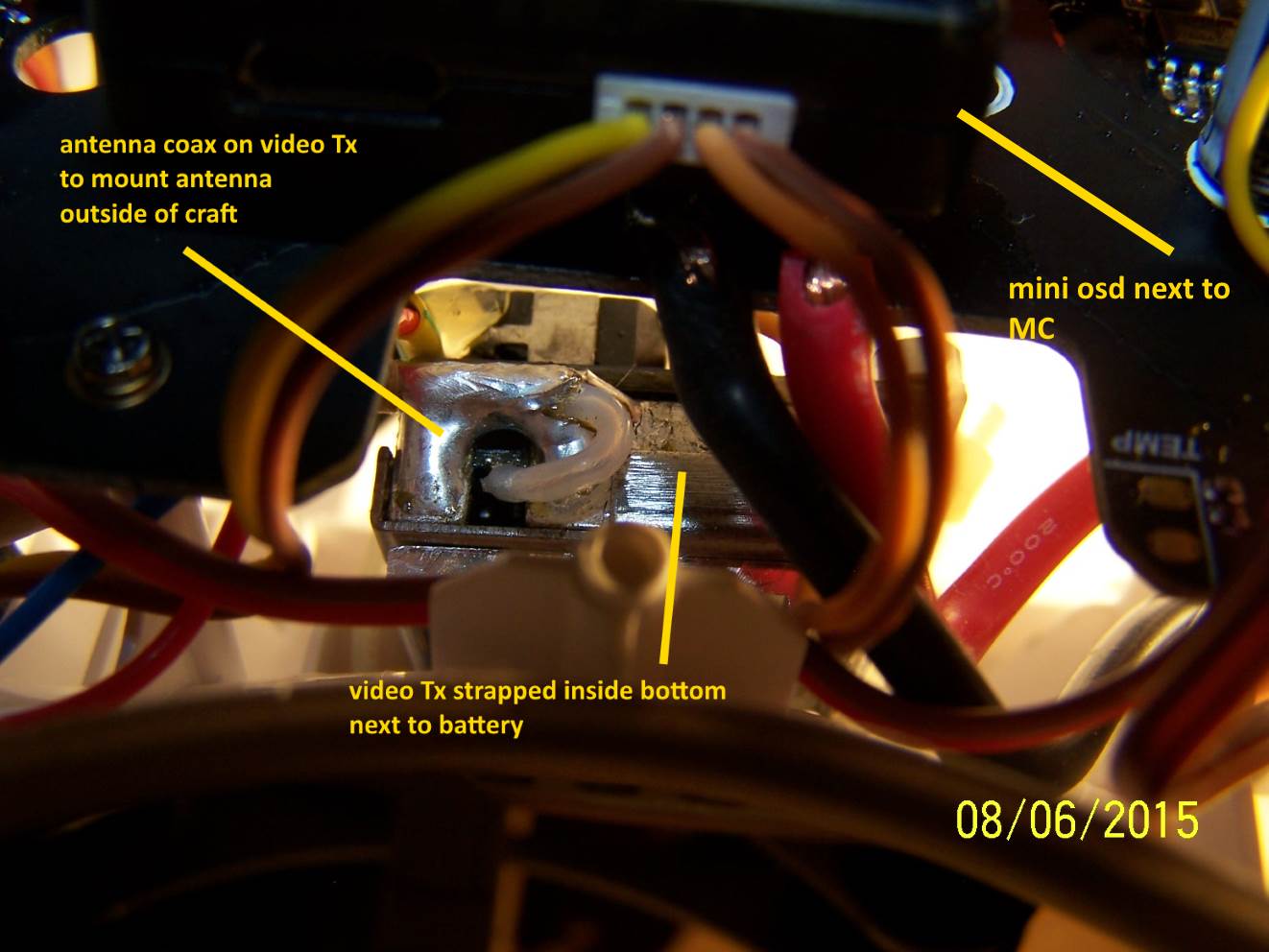

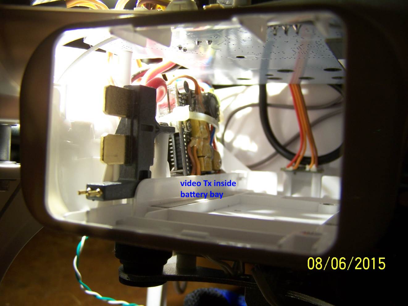

I see the VTX inside next to the battery. Any issues with heat build up .I know when I flew the last couple of days in 90* Temp.When i pulled the battery it was quite warm. And my Transmitter was on the outside and it was also warm.
Sorry I haven't replied sooner.... been modding my P2 (still!).
I did take that into account when mounting the TX and was a little concerned about heat.
The heat sink is just siliconed to the top of the RF shield and is not really sinking any heat from the IC's inside... kind of a "dressup" not-really-functional heat sink, but I imagine it does do a little something.
I did fly around for a short while in the backyard and it didn't seem to get very hot.
It does get warm, but not too warm.
In the P2 where I have it mounted, I purposely mounted it so the heat sink on the top of the TX is against the slots in the body of the quad, just for that reason.
