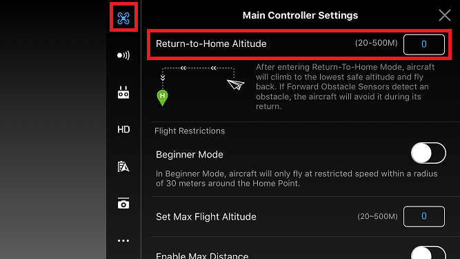

When RTH is initiated, your Phantom will ascend to the RTH altitude before returning home (if it's not already above that altitude). You can change the RTH altitude in the following section of DJI GO:
Note: This setting is also set in meters. It can only be set while your Phantom is connected to DJI GO.
