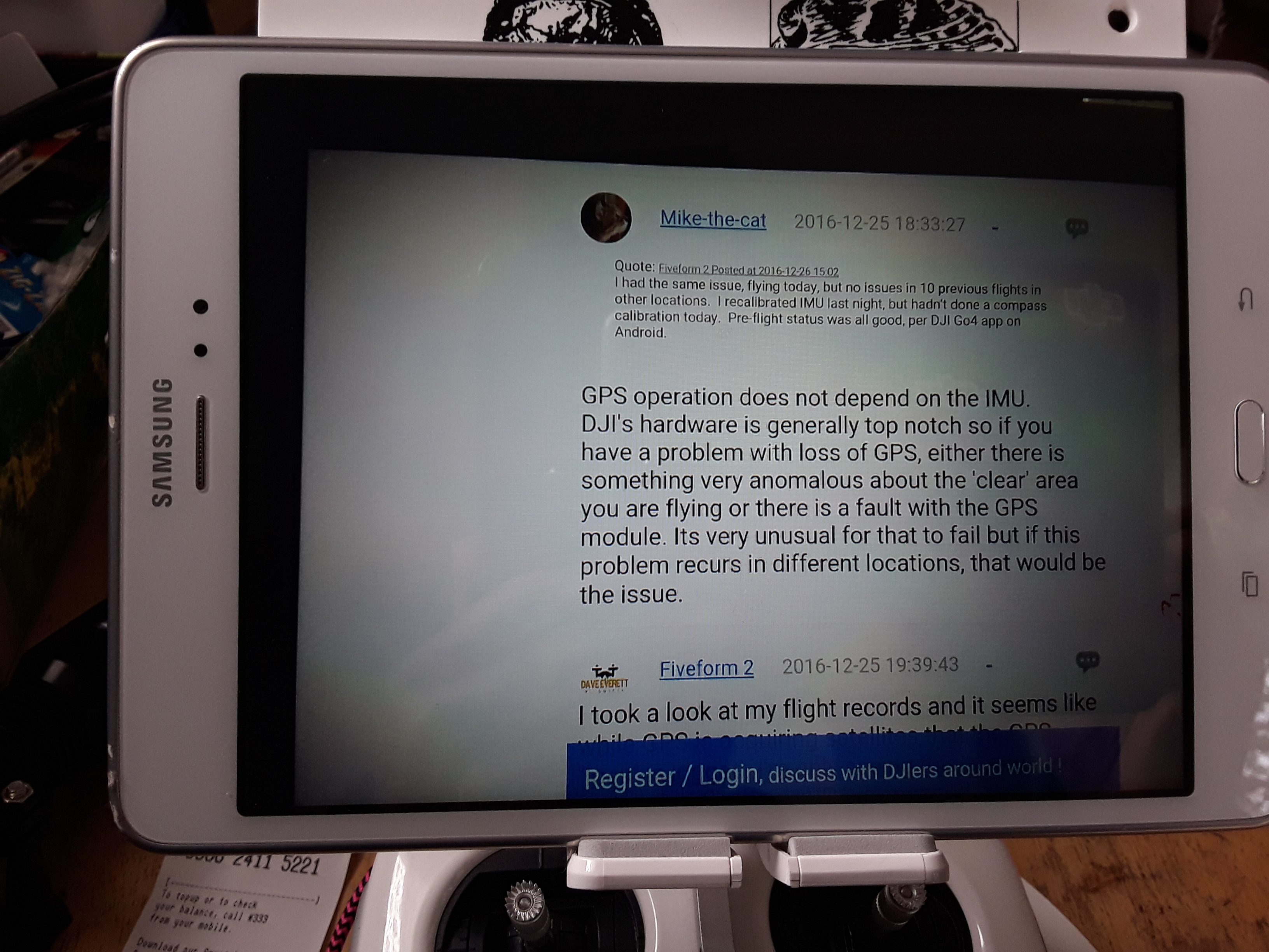

found this post,there's a few likes this says if tried other locations gps might be faulty

View attachment 82960 found this post,there's a few likes this says if tried other locations gps might be faulty
