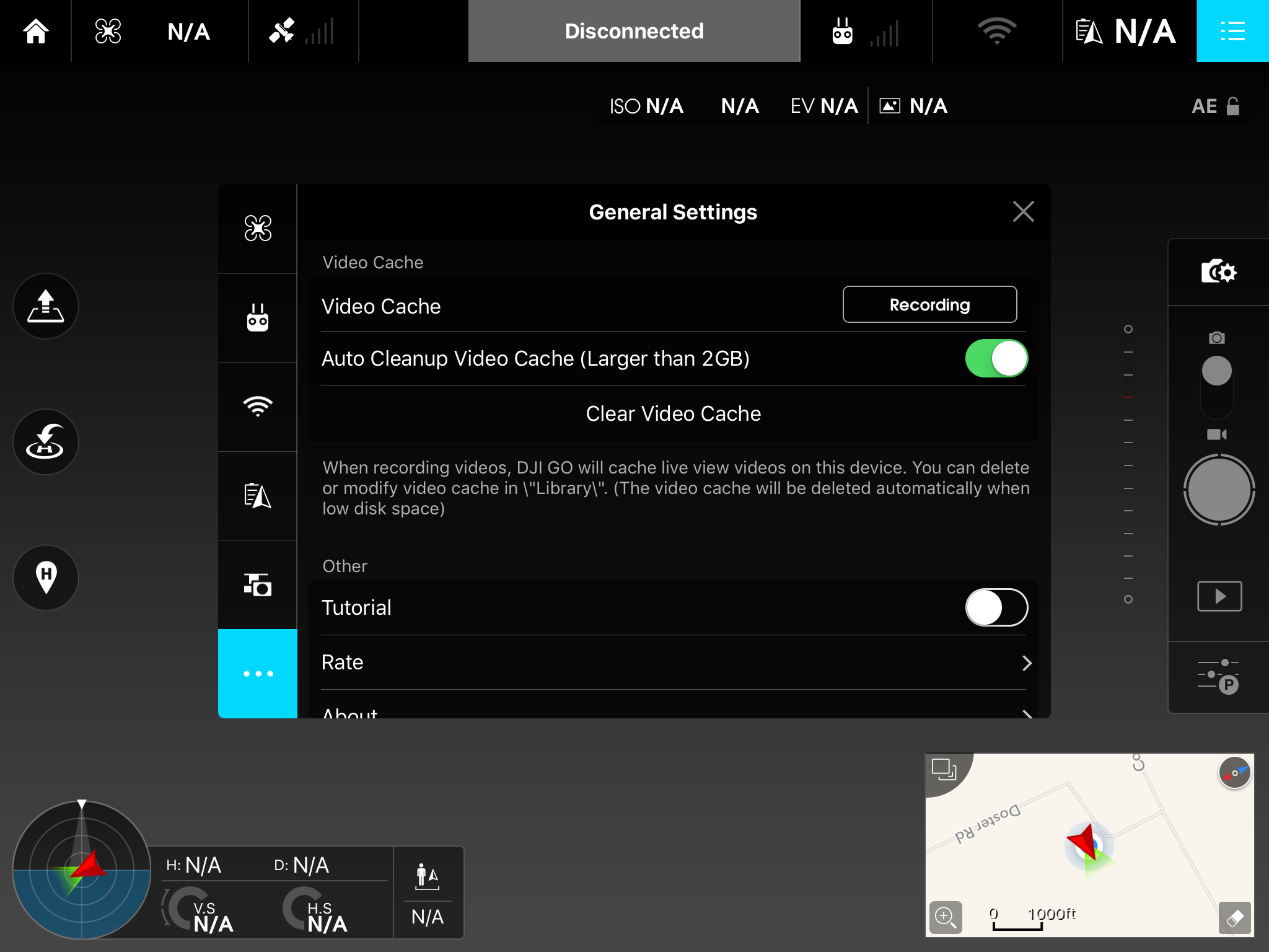

. What is that under or in ?"Cach locally while recording"
When you go ro camera view click on the settings at the top eight and scroll down to cach.Glad you got that took care off !!! This app is the only thing I have a problem with and all the settings . I just looked to see what mine is on
and can't find . What is that under or in ?
You must not have the standard. But it looks similar to mine. Where it says recording next to video cache, can you turn it off?Well ya got me on the ...top eight ...and ether ya have to have the bird powered up to see that or I'm still lost..not unusually
Here's what I have found though
Ya it's the standard and you see it's on so yes it can be cut off . Mine is not crashing though but I am trying to learn this app .You must not have the standard. But it looks similar to mine. Where it says recording next to video cache, can you turn it off?
After looking at that setting again all that swith does is what it says to the left of it . I always pull my stuff off the card and reformat itYa it's the standard and you see it's on so yes it can be cut off . Mine is not crashing though but I am trying to learn this app .

I'm gonna cut it off to see what if anything changes with mine .Am glad that fixed yours

Mine looks like this. Come to think of it, it was always on. I always cleared my card and cache too but from what this guy was saying, it also saves video cache on your phone too. I guess it built up and then caused the crashing. I'll link you to the forum I saw where he explains step by step what to do. I did it and then went flying and got 17 mins on 2.7K and max distance of 2000ft!!!After looking at that setting again all that swith does is what it says to the left of it . I always pull my stuff off the card and reformat it
each time I fly and later delete it from the library in the app also . Not sure where you cut of that Recording to the right of Video Cache .
