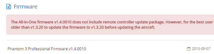

I have a Pro. It updates to "1.04.0010" I can't get the RC to update. I had been oon the immediately previous version, so I thought it would update via Go, but I can't tell. I tried the USB drive method also. I don't see any new features on GO either, and I am connected to WiFi.
The RC doesn't have an 1.4 update. ..the highest rc update is 1.3.2.......the new GO features are not available until flying in the air and then you have to flip the toggle on the controller from P to F and a menu should appear telling you to enable multiple flight modes and then after that you should see the new options.

With regard to versions, I was referring to the P3P FW ... odd that it all refers to 1.4, but the Bin file and txt confirmation says 1.04
