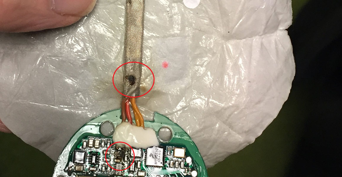

hi guys, here are some pictures to show you what i have done with the gps module and a video to show it working, problem is it is drifting slightly to the right.

You need to center that board over the over the plastic standoffs then either cut black fiber shield off the the cable or slide over the connector as i see it has been modified. Another pilot had that shielding on his P2 and it came in contact with components on the board and shorted out the board.
i am very sorry but i dont understand what you mean by 'center that board over the plastic standoffs ' and 'slide over the connector'.
do you mean take the black cable off the gps board or put it back over the original copper shield?
it all sounds very technical, could you explain again please?
many thanks again for your help.

Ok now the board is centered but you still need to remove that black covering on the cable as it is not necessary and can cause a short as in the photo i sent.

i thought you said i could put the cable to the side so it wont touch any components?
That covering is not needed and was not used for long by DJI besides the wires are coded and the shielding is not needed.
Reactions: froggy8
thank you, i will remove the black covering now.

i have now removed the black cover
Well that looks better now reassemble it and have fun.
