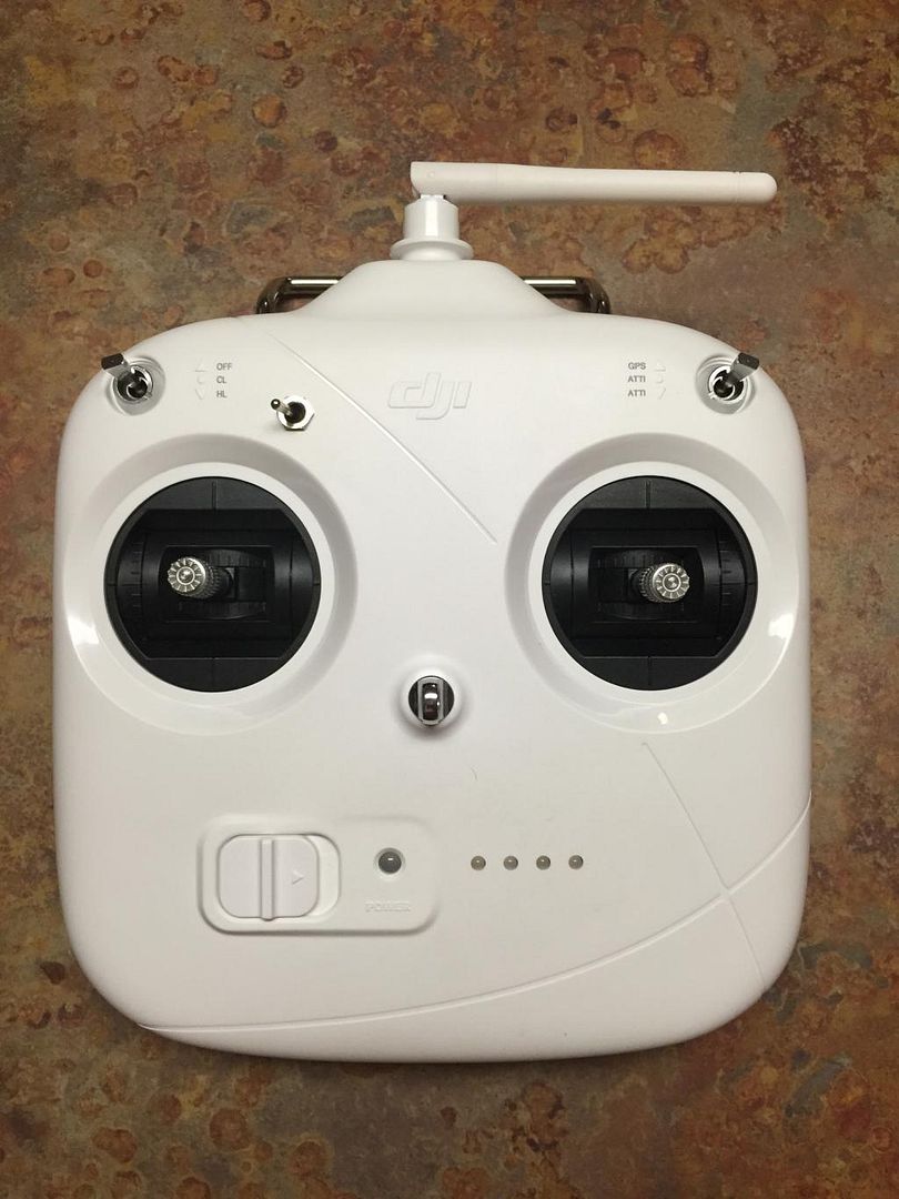

I modified the yaw control on my P2 last night using Peter Homer's modification. I mounted the switch in between both sticks and had no need to add extra wiring. Bench tested it and it works but haven't tested in flight as it's -14° outside at the moment. Putting the switch together may look simple to do but it isn't.

The mod works like a charm...Here is an example of where I placed to toggle. It looks factory. BTW I used speaker wire not yellow and black wires and it still worked.

Putting mine in the center between the two sticks I didn't need any extra wire. Tested mine and it also worked great.

I also place mine in the middle in a vertical position. So it makes my brain say "S1, S2 and Yaw = up position to start motors".
