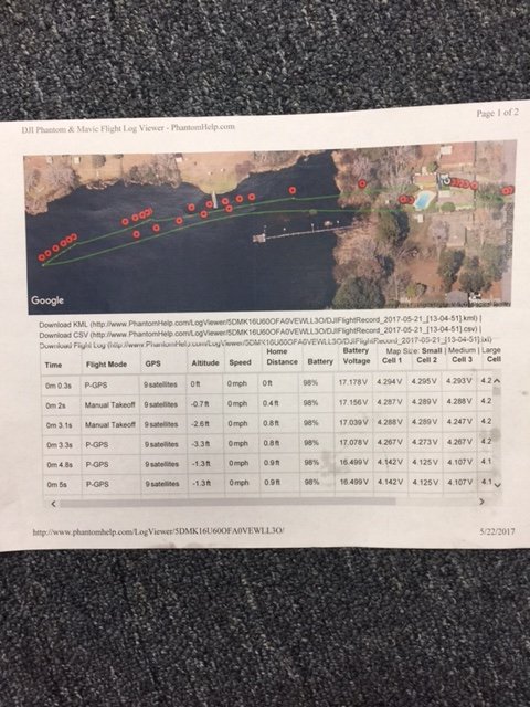

Can someone please tell me what the red circles with black dots mean on the map of the AC's flight path when using DJI Flight record viewer? Thanks

The log viewer above is my log viewer. The points on the map signify important events in the flight log. Those events include the following:
If you click a marker on the map, the table below the map will scroll to that location in the flight log.
- Message or warning displayed in DJI GO
- Flight mode switches to/from ATTI mode
- Battery level reaches an increment of 10% (e.g. 90%, 80%, 70%, etc.)
