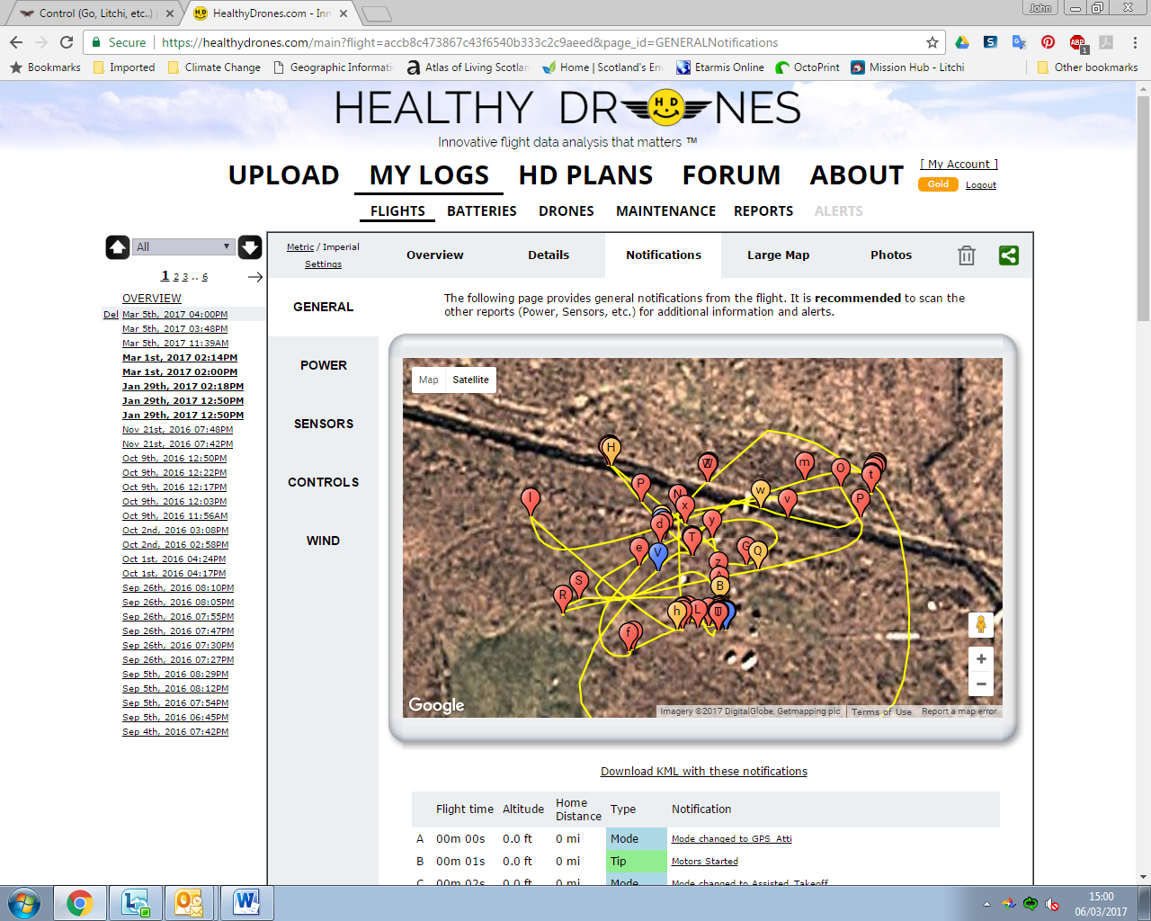

This was the notification screen in Health Drones yesterday..............
