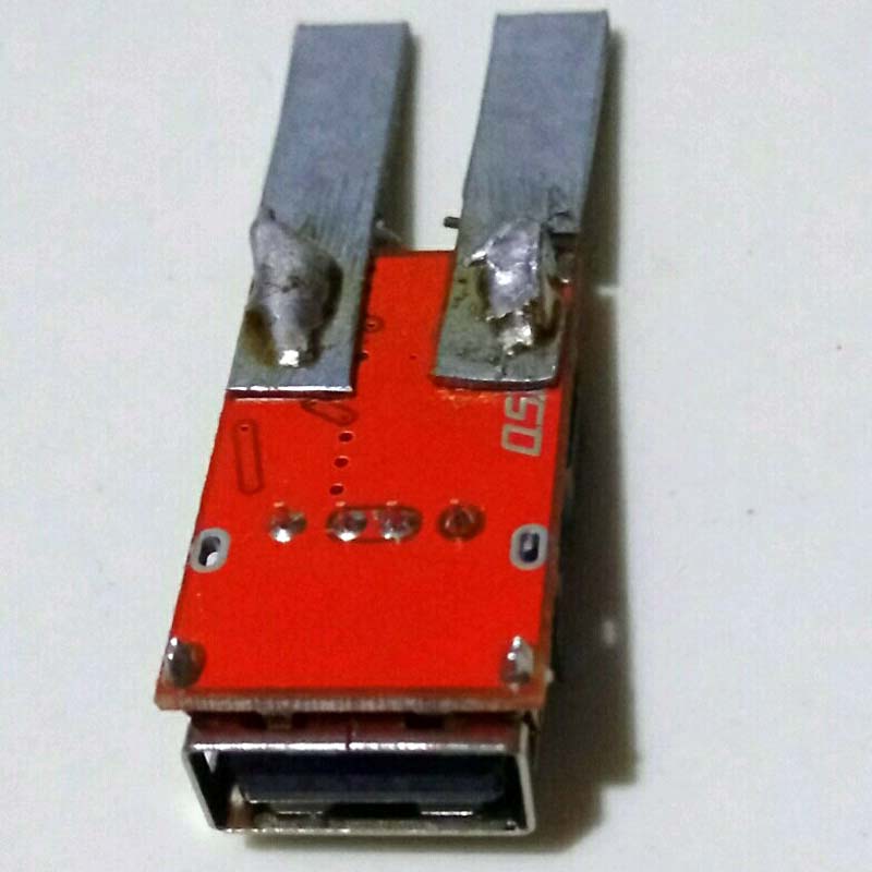

The idea is when we need to manual discharge for battery maintenance or we are in a location away from the power supply while hp, tablet or remote need it.

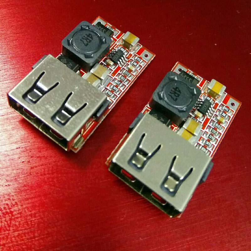

The material:

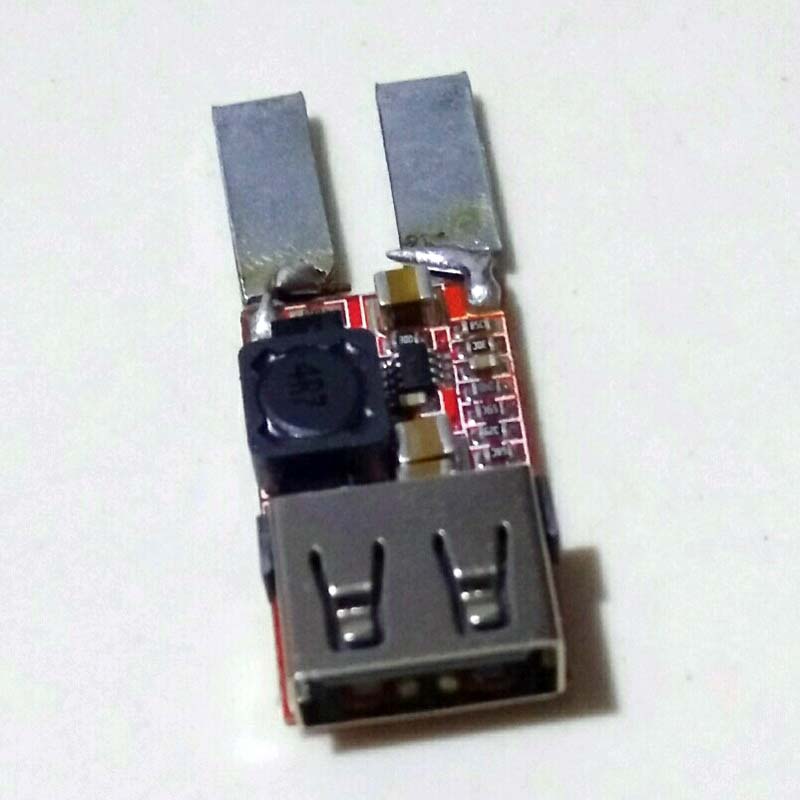

1. Step down USB:

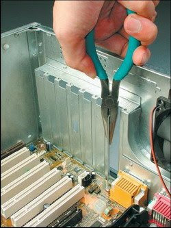

2. Plate from rear pc:
After cut and soldered the plate:

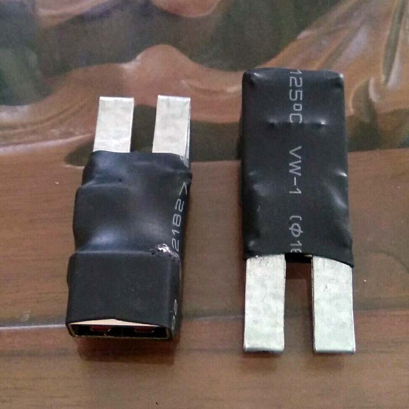

Covered with heat shrink:
