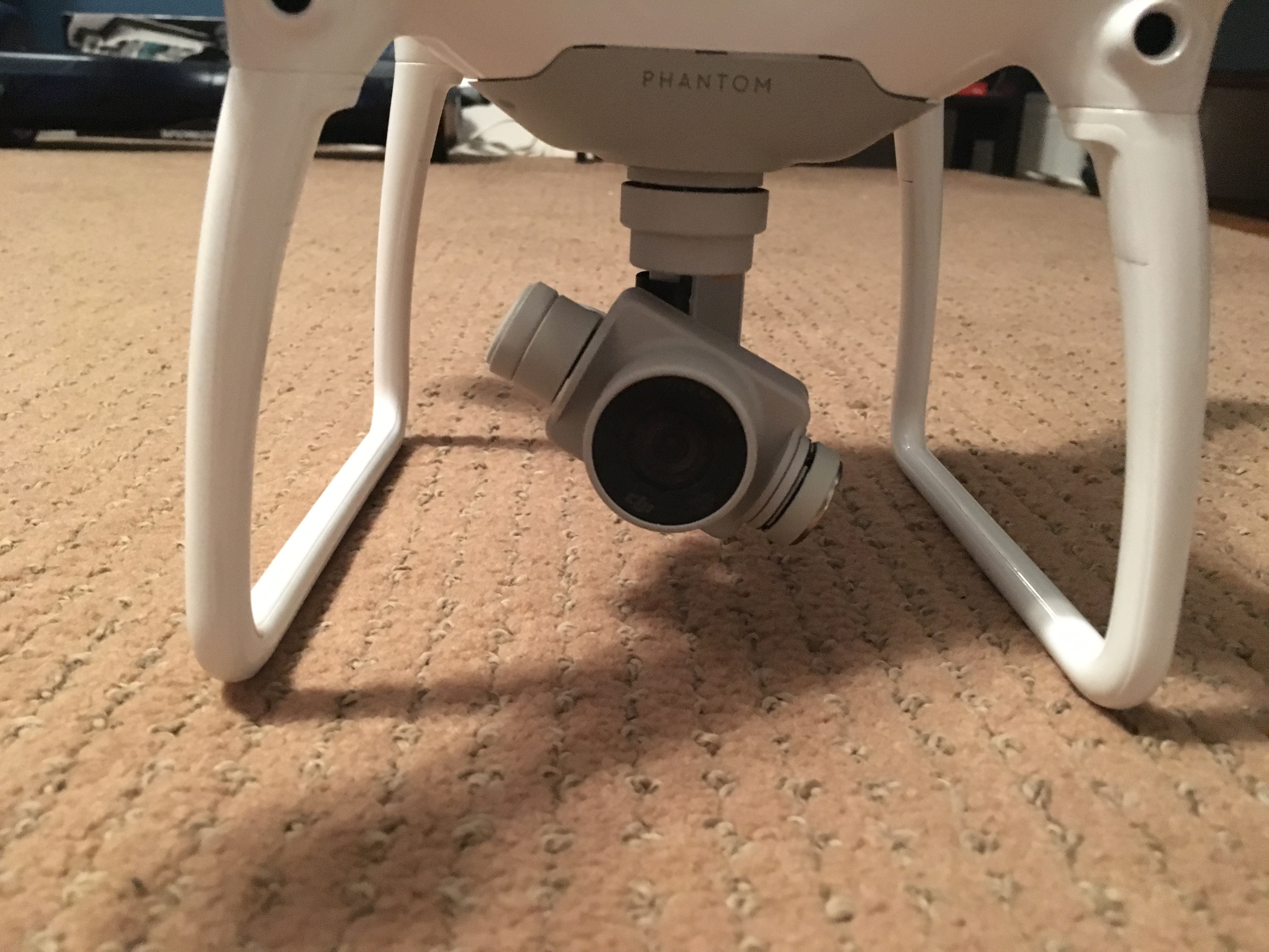

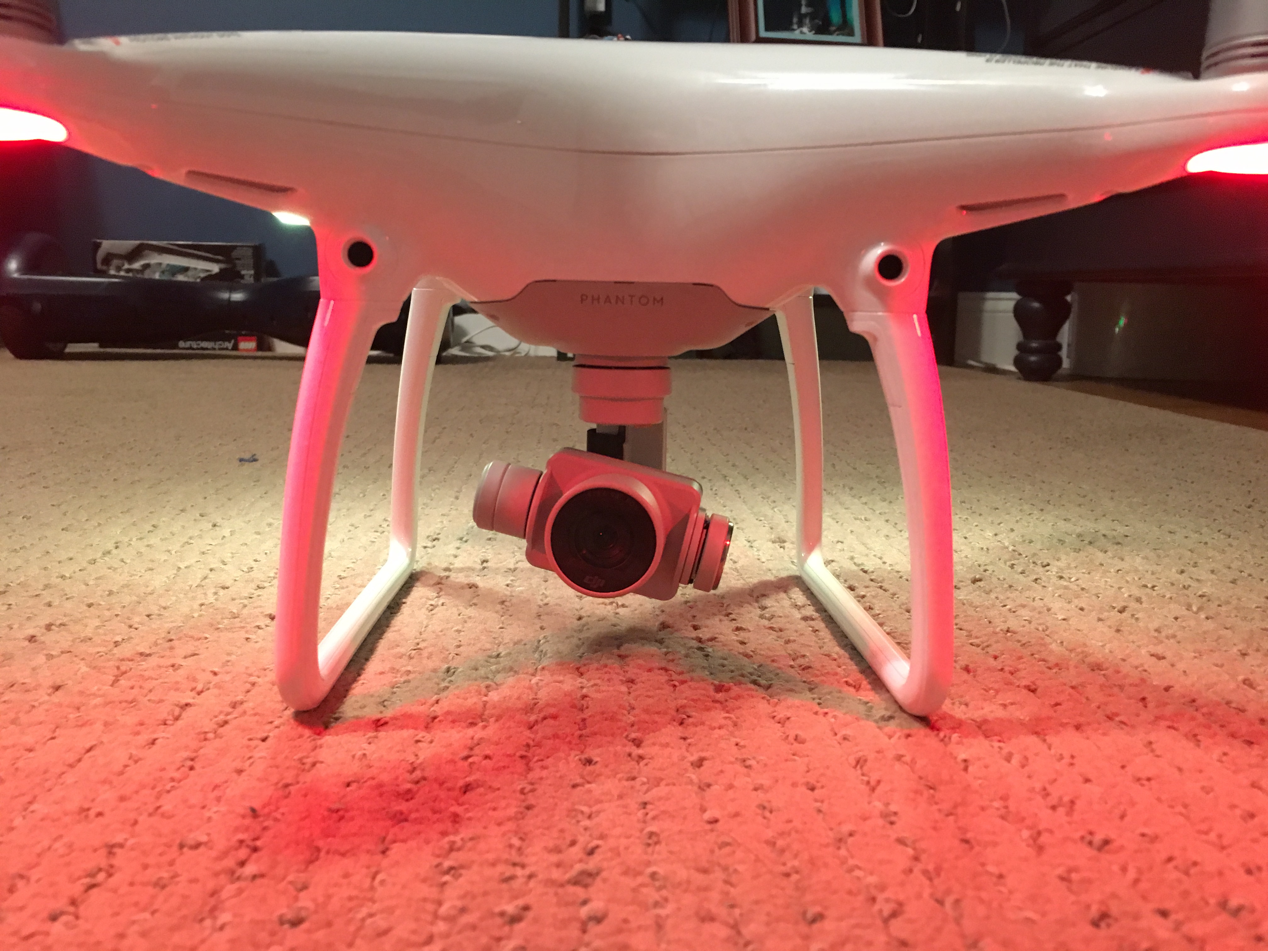

Hi! So I'm desparate to repair my drone and I have had no luck replacing the yaw arm, i replaced it yet I still encounter the gimbal and camera being crooked (see attached photo). Does anyone know if I should replace the roll arm, as in will it fix my issue? If not Is there anyone looking to sell a used or new gimbal assembly?? Please let me know.

Hi! So I'm desparate to repair my drone and I have had no luck replacing the yaw arm, i replaced it yet I still encounter the gimbal and camera being crooked (see attached photo). Does anyone know if I should replace the roll arm, as in will it fix my issue? If not Is there anyone looking to sell a used or new gimbal assembly?? Please let me know.View attachment 74297View attachment 74298
Looks to me like there's a little bit of separation between your gimble housing (part that says Phantom) and the shell. Mine is super tight with no gap. Did you recently crash? Is it possible something inside is not connected from when you replaced the arm?
