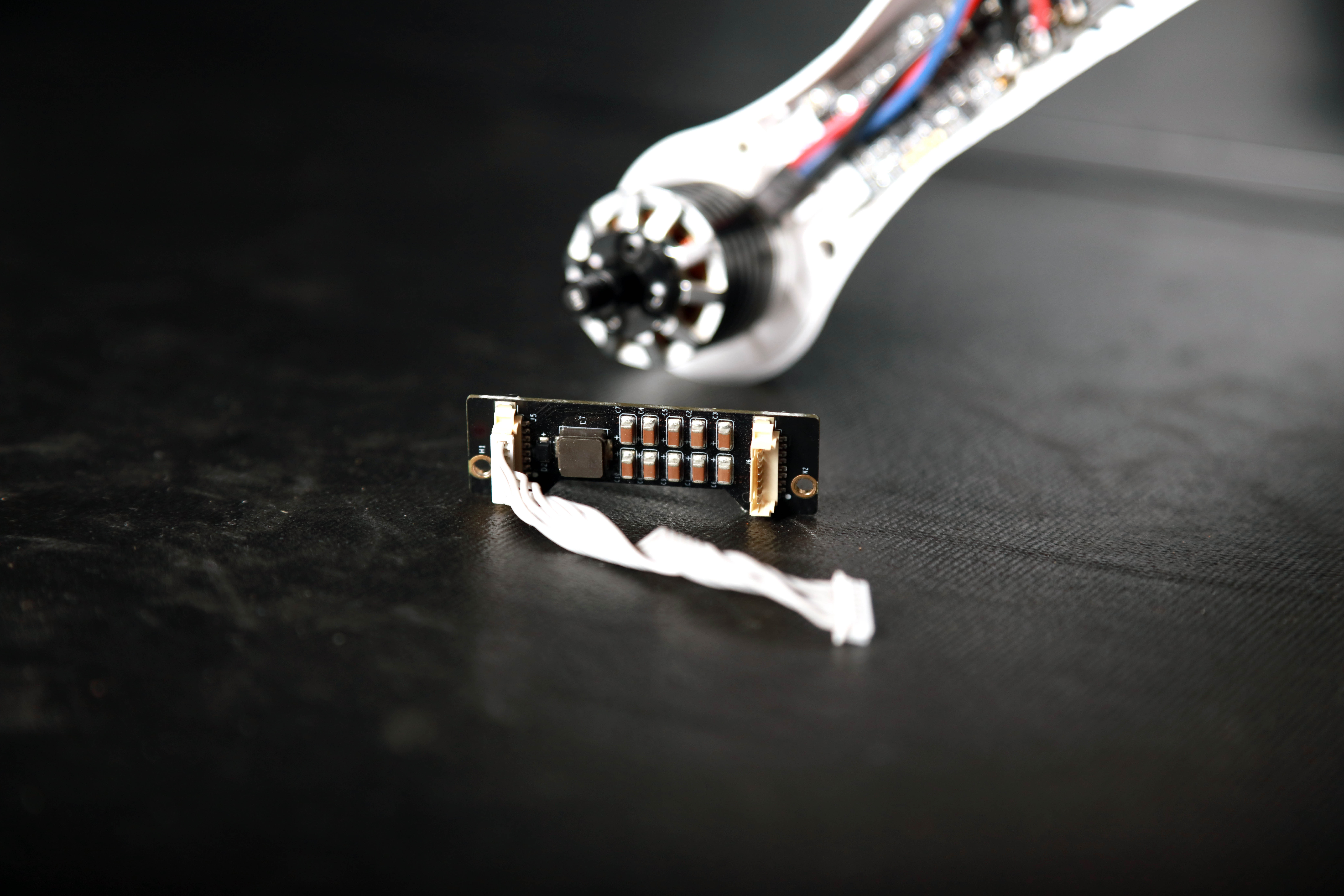

OK, so this is my issue with my Phantom 2 Vision Plus. I left it setting on the shelf for over 6 months and now I have the following happen when I turn on the aircraft. The aircraft starts up normally, I get the flashing start up light and start up sound. The gimbal starts up and stabilizes, but the record light illuminates Orange and never goes off. The app opens and connects to the wifi perfectly. I show good wifi signal and 100% charge on my extender. There is no indication of battery remaining, GPS satellite connection number and there the app shows I do not have a SD card inserted.
I conducted the PING test indicated in this thread and all three pings resulted in replies, which shows me all three boards checked, checked back good.
I am thinking the board that comes in the cable pack #21 may be the issue, either that or one of the cables. I have not had any issues with this aircraft, flew for over an hour the day I placed it on the shelf with no issues what so ever, including recording video of the entire flight day. Is there a way to test the board that comes with that cable pack? I have embedded a photo of the board in hopes somebody can help.
Thanks, Lee
