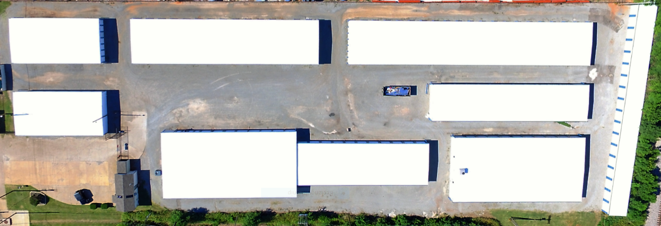

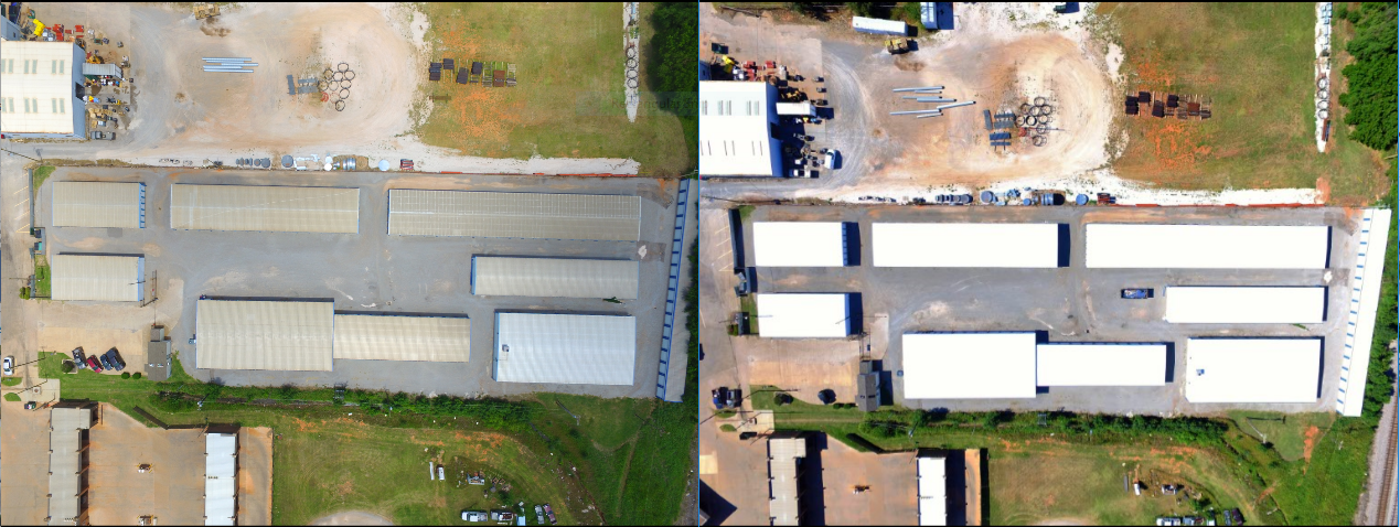

Can photos like these be used to calculate square feet of rooftops,
Since software and aps are constantly improving it seems a current question would be ok.
Providing these photos to customer for whatever reason they may like to use them for made me wonder if someone could use something like this to measure exact surface dimensions. That could save a lot of work as opposed to manually measuring?
What would be easiest way to do something like that. Thanks.
for sure but i was looking at this for flat roofs. This is a relatively flat roof.
I guess you could put two orange cones like 10,25,100 feet apart for reference.
But i don't think you could do easily scale it correctly from this high up using that method. notice the check in house thing looks narrow compared to the blue vehicle parked inside the gates.
Possibly it you were to fly at a known fixed altitude centered directly over a roof. It could be possible if the roofs were flat. You could make different formulas for different altitudes. If you had a laser type measuring device to measure roof peak to lower edge. You could do sloped roofs. I'm a retired pipe fitter. So you know how good my advice is. LOL
